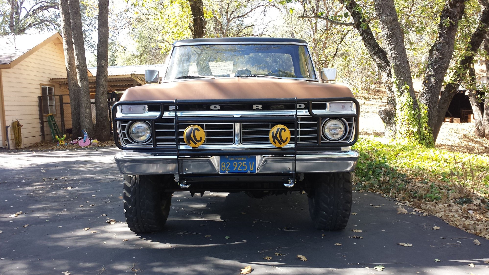

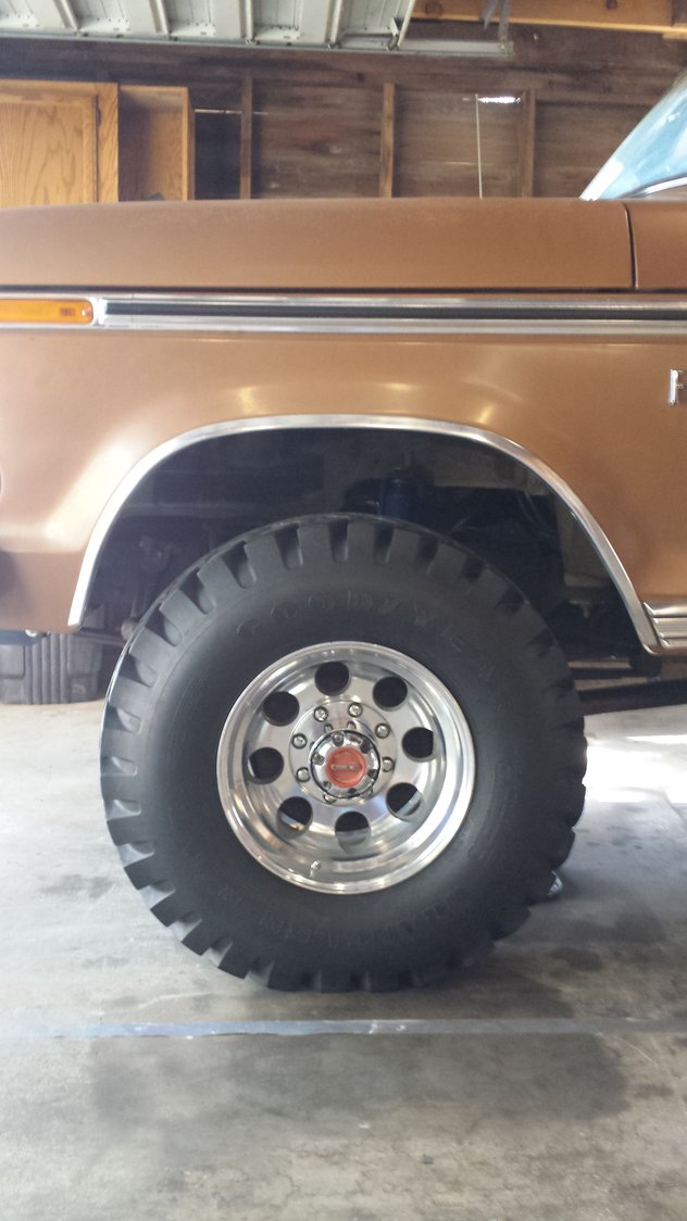

These tires look and fit great. Will be taking the truck on a week long camping trip to test them out later this month

Glad you like them. Personally, I think their old school look complements these trucks

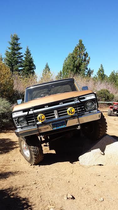

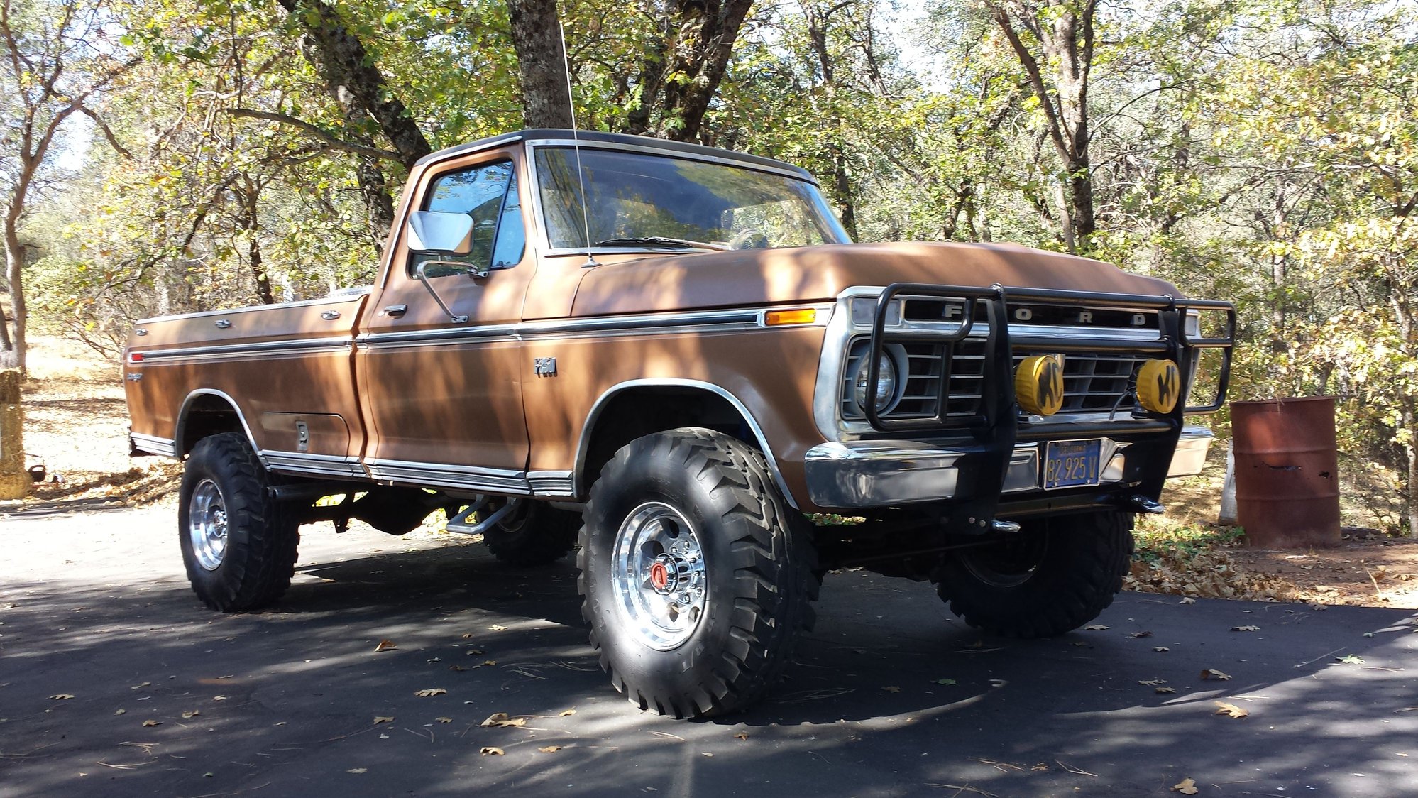

Took the truck out camping last week and I am very happy with these tires. Honestly the road manners are not so good. Reminded me of a set of super swamper boggers I used to own. But they seemed to get better the further I traveled down the freeway. Spent a lot of time on dirt roads, lots of big ruts and bowling ball sized rocks. Also plenty of small ledges and sharp rocks that could do bad things to a tire. I never even shifted into 4 wheel drive. The tires handled everything I threw at them with out any problems. Over all considering the price I am very happy with the purchase. Here are a couple parking pics, didnt get anything better. Busting out the grooving iron this weekend hopefully to add a little additional life to some of the lugs.

Bias ply drive better once warmed up, make sure they are not over-inflated. Will eat out the center tread quickly. Be VERY VERY aware that they are NOT wet road well mannered at all.
FYI grooving them might not let them pass DMV/insp station? Worth a call before you put the groover to them?
Keep an eye on the tire pressure often and rotate at 5000 religiously. If your ball joints are bad you will know if by a cupping on the outer side every other tread.
