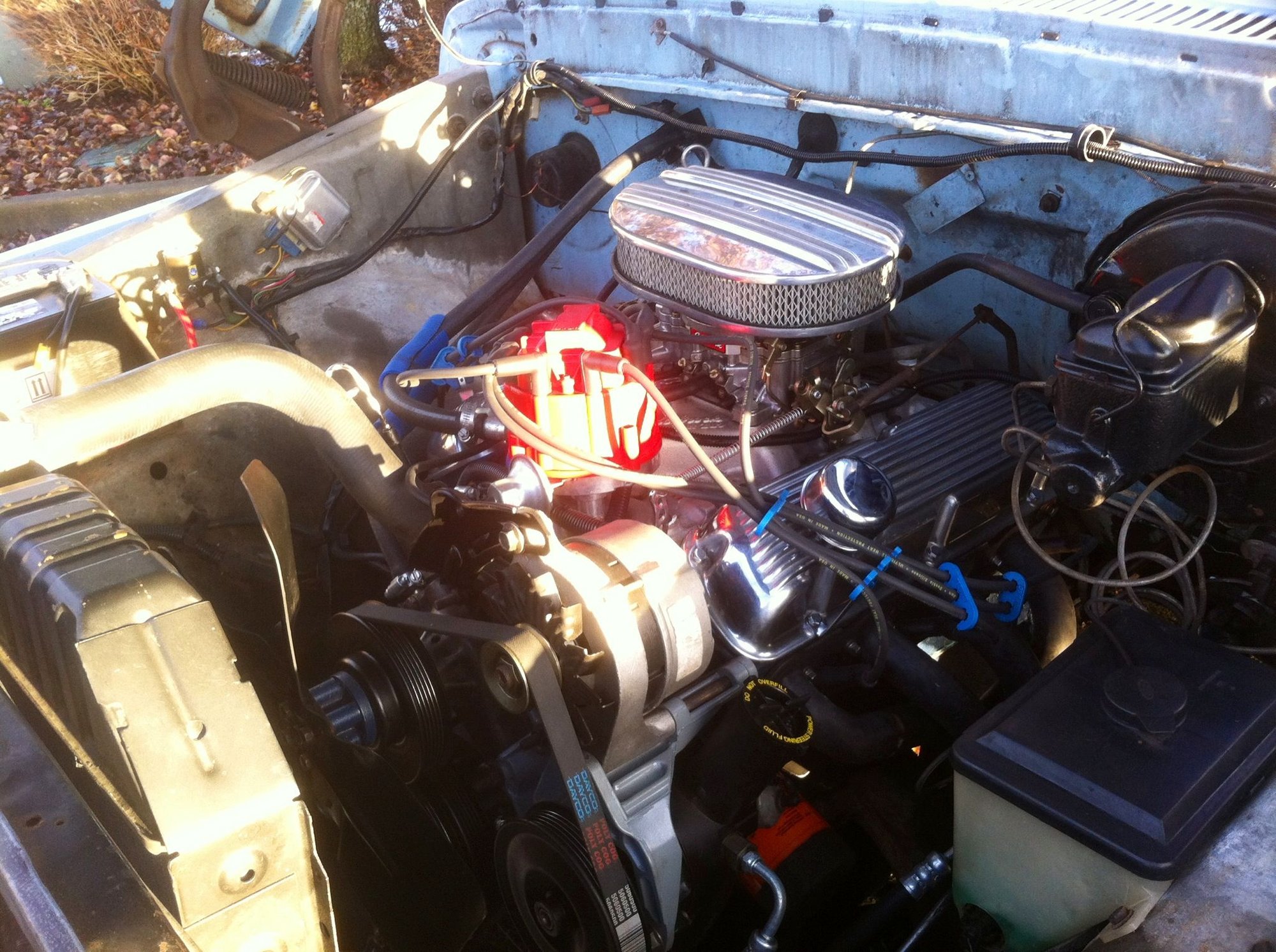

The truck still runs like a champ ans fires right up. She's been a reliable daily driver since the day she came to be with me. The relatively fresh 302 has gotten a few much needed tweaks and upgrades! After the Initial fluid change and motor clean up I noticed a leaky VC Gasket. I grabbed a good set of Felpro gaskets and oddfordjunkie stopped by to scope out my truck and we each slapped on a gasket. Bam no more leak. We got to talkin about things I wanted to get done and John offered to find me the parts for my PS adventure and anything else I wanted. I had him scouring the yards for PS parts and after a few false starts we eventually got a full serpentine pulley and bracket set which all got a cleaning and coat of fresh paint, and were then mounted to a new waterpump. We installed also a rebuilt PS Gearbox (also scrubbed and painted), a fluid cooler coil, and a replacement column to accommodate the bigger gearbox. The column was about as loose and free as the original so it got a new set of bearings and clips. I can steer the truck with two fingers now and its all a nice clean looking package.
We tuned the carb and timing a bit and got things smoothed out. Since then I've installed new Motorcraft Plugs with the gaps opend up .010 over factory, and a set of new wires to match. I tweaked the carb a bit more to obtain the best overall response. I also spent a good deal of time in clearing up and organizing the engine room. Al wires running through heat resistant conduit, and running away from moving parts, etc.
BEFORE:
AFTER:
I have some better pics of after but I cant seem to find them on my PC.
Next On the LIST is eliminating an aftermarket temp gauge and plugging the port in the intake that the previous owner used to install it incorrectly causing intermittent vacuum leak, and loss of performance. Then one more good tune. Then Its Break day when John gets me the Hydroboost. I've got new rotors pads and bearings for the front, and new shoes and clips/springs for the rear. Today I'm Hoping to get the new stereo in SO I CAN HAVE SOME TUNES!! John also gave me a factory radio which I will be adding an auxiliary input to for iPod connectivity and it will go in when I get around to the interior.
