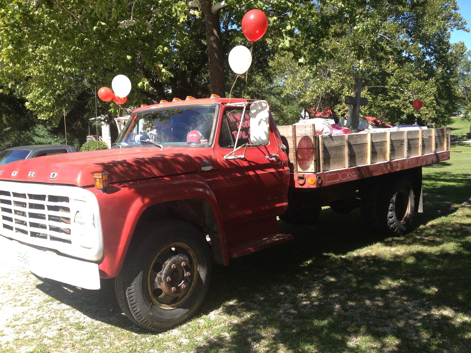

Hi guys, I'm new to this forum but need some quick help. My buddy has a 73 F600 grain truck that he's planning on using for his wedding hayride this Saturday and the darn distributor went out on it. It has the 330ci engine, and we can't find a replacement anywhere. Will any of the distributors from the other size engines fit the 330? The fourth digit of the VIN is a "d" so its the heavy duty 330. Any help would be appreciated. Also on a side note, a local guy has a 1970 (also has a "d" in the fourth digit of the VIN), but the distributor looks different from the outside, I think it has been replaced. Would this distributor fit the 73 model?? Thanks in advance for your help!

I don't know much about these things, and wasn't there when it quit them, but he was taking it down the road to fill it up with gas and it quit on him. Said it will run all day at idle, but when you get going it cuts out. They took the cap off the distributor and he said the whole thing was loose inside so I guess its getting all out of whack when you get to going down the road. Another idea was a vacuum leak, but I think they checked that.

Well we finally got it running Friday afternoon. Ended up replacing the fuel pump and cleaning the carb in addition to rebuilding the distributor. Everyone was definitely glad we went through the extra work, as it was a one of a kind hayride! Bill, thanks so much for all your help!
