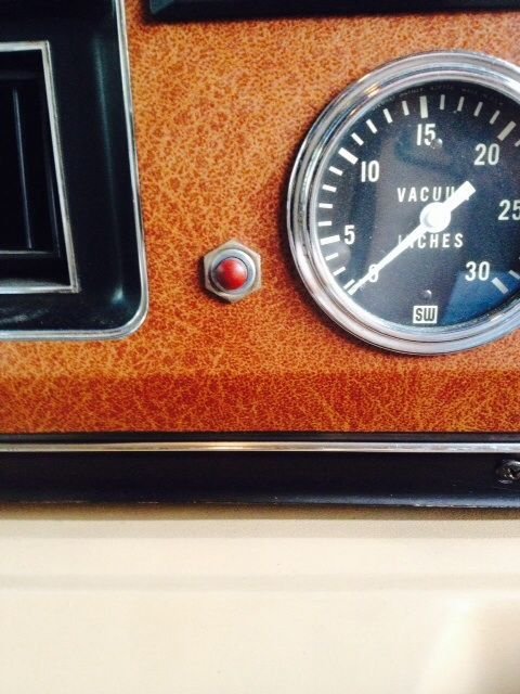

Has a fuel pump override button on the dash.....is this an oil pressure work around? Hit the button and you can hear the pumps.
So going to have to go through the tanks, filters and pumps I guess.
