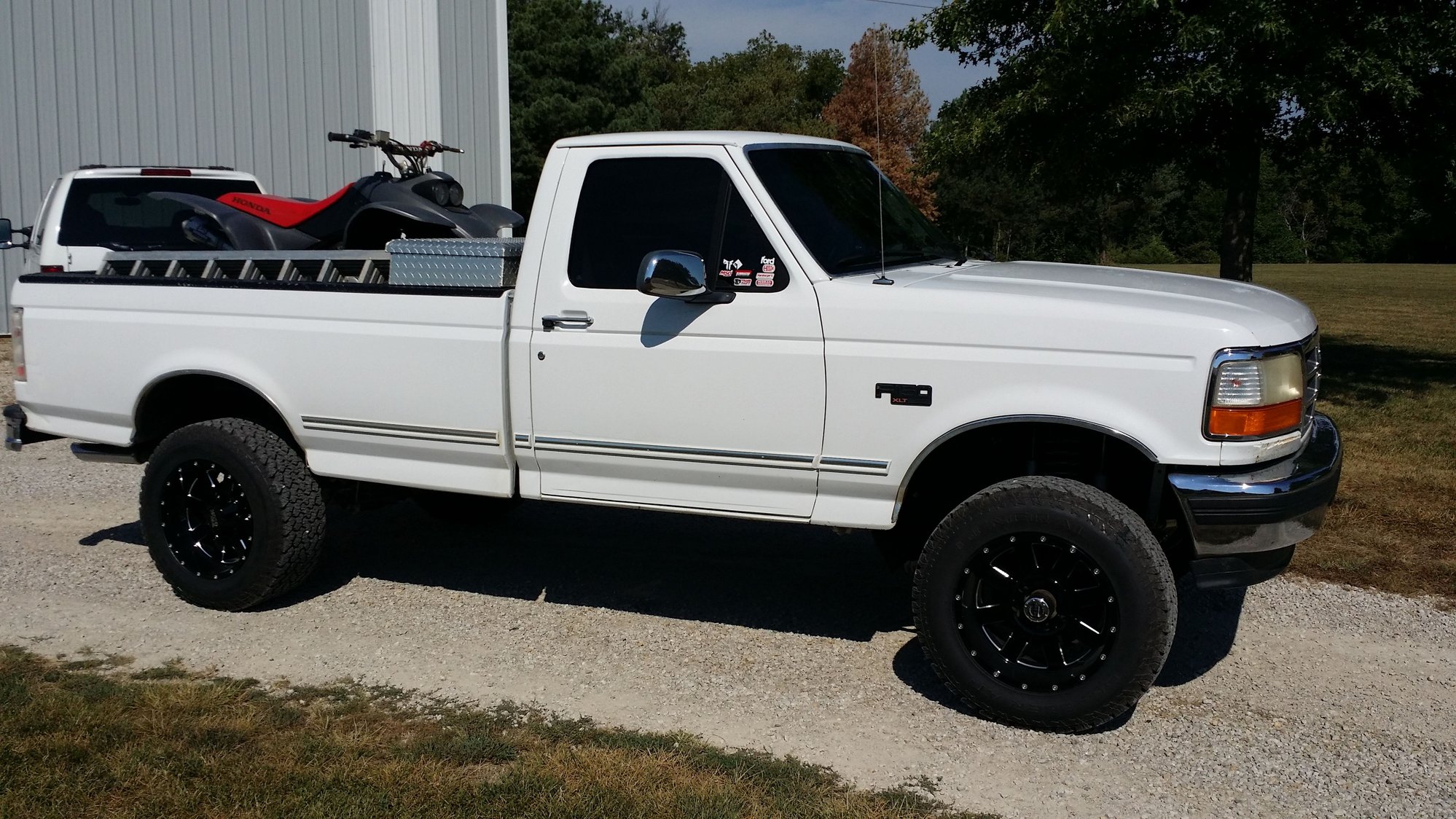

4 inch lift with 33x11.5x18 the wheels do a have a -20mm offset and there is no rubbing. Would have plenty of room for another inch wider tire
Looks good man! That's a -20 offset? Is there any back spacing on those? And could you send me a picture from the front just so I can see how much they stick out
