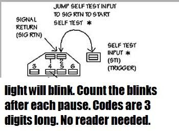

Just so you're aware, there is a way to read the codes from your OBD-I equipped truck with a paper clip. The how-to is in a "sticky" thread at the top of our forum.

Use a jumper on your obdII Google how to get codes on you tube for your year truck and boom done but pay attention to the dash light. The obd is on drivers side fender when you lift the hood

In the future you dont need a code reader. you can check the codes anyplace as long as you have a piece of wire. count how many times the check engine light blinks. Print off the code cheat sheet and throw it in your glove box.

As for the Innova vs. reading codes with a jumper, all the code reader does is save you the frustration of miscounting a code and having to start all over again. I'll know I'll be buying one next time I own something with an OBD1 computer system, because without fail someone or something will interrupt me while I'm counting. Lol.
