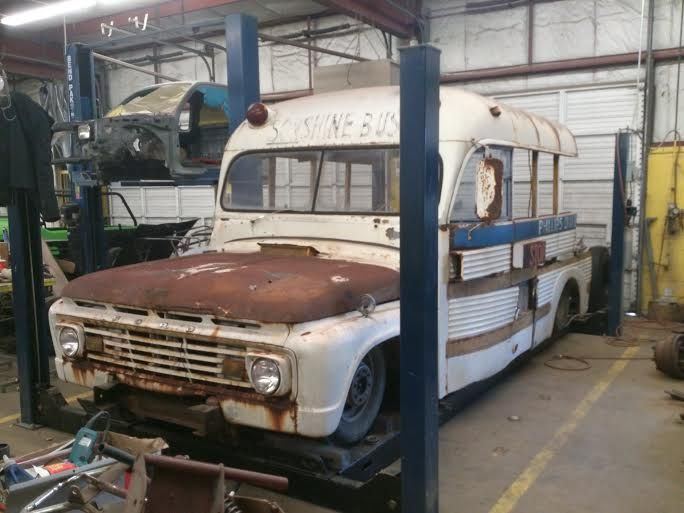

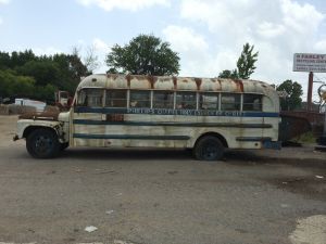

here is the bus at the scrap yard. I have been looking for a short bus for a hot rod project at school. This one is not short but will be in the future. I plan to remove at least a 3 window section from the middle then move the rear forward. We also plan to drop the bus but want to do so with as many ford pieces as possible. I have a 3 deuce set up for the y block I would like to use as well. I have been looking up info on better gears for the rear but may have to swap to a newer one and adding an overdrive trans. I would like to hear input from any one who has updated one of these or similar truck.

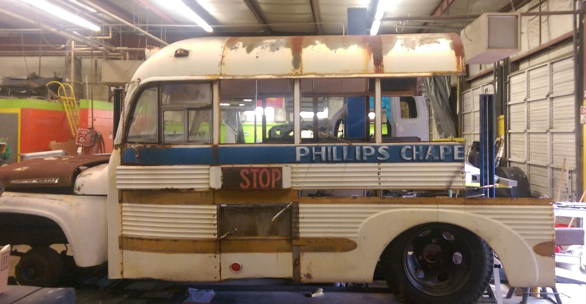

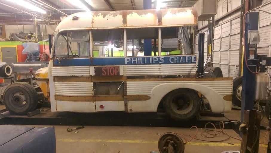

here is the bus with 3 window sections removed. we are in the process of moving the rear axle forward. plans for now are a 2 link with bags and a very low stance. Once the axle is moved the rear section of the body will join together in a factory seam

got the bus in our shop. We are setting ride height and rear axle placement. Hope to have the rear section back on soon

working on stance
installing a dana 70HD with 410 gears, much better than the old 720s
found a narrower front axle with a deeper drop
working out mounting details
should be able to run regular front sheet metal now
