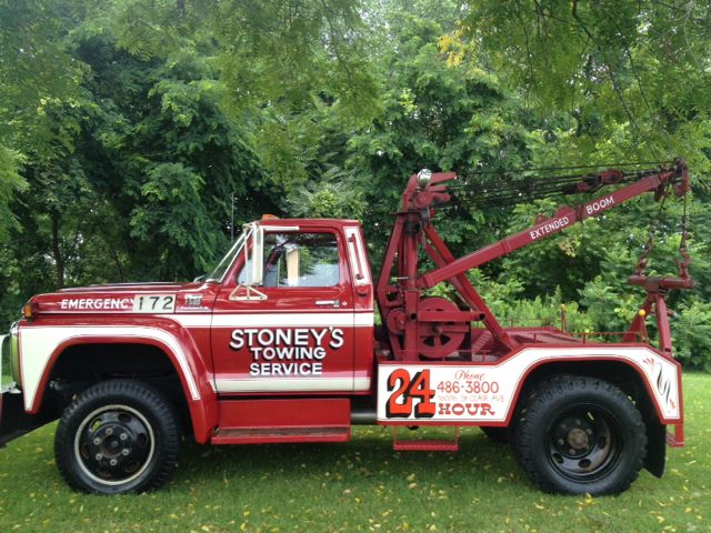

The pic of the truck is the 74 F 500 I bought last year. A friends uncle had a tow shop and he passed a year or so ago. I am now trying to buy a F 750 ( the vin plate), but don't know a lot about the truck, so I was hoping for some help.
