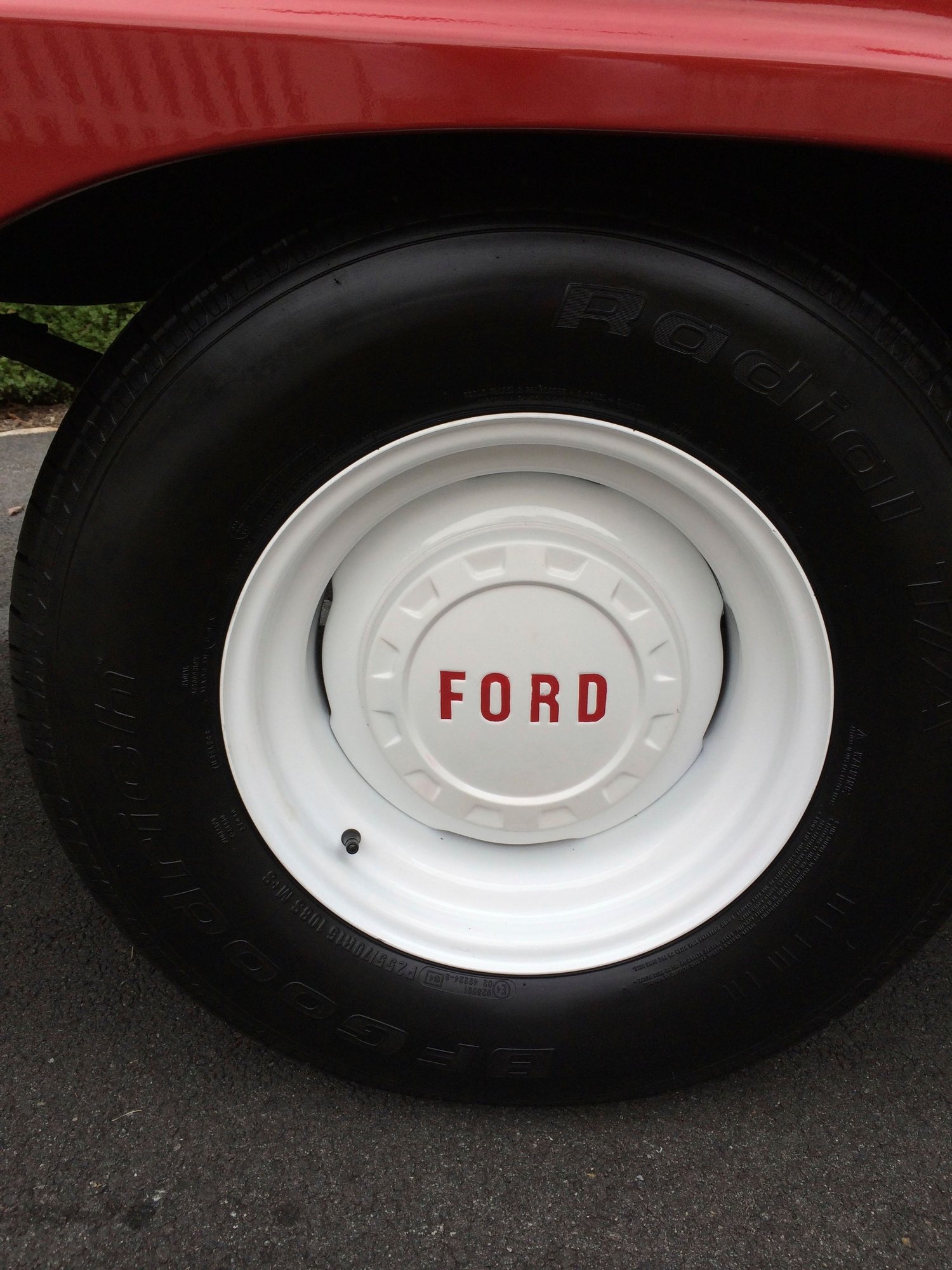

Hi….I have a 1966 F100 standard cab that I've been restoring. My question is which "white" is correct for this truck….the stark white on the wheels and hubcaps OR, the white on the grill and bumpers. I personally like the stark white but think the whites should match and the white should be correct for the truck?

The creamy white is Wimbledon white, or close to it. The other is what I call "Chevy white" and in my opinion is incorrect for any Ford truck of the period unless it was ordered as (I think) "Polar" white. All two-tones used Wimbledon white although not everyone agrees with me. Like everything else.

The color of the hubcap ( whimbledon white ) is the correct color used on wheels, grilles and bumpers when your 1966 F 100 was built new. Whimbedon white is an off white, not a bright or gloss white. Other items if your interested in the "factory look" :Turn signal bezel was anodized aluminum. My biggest pet peeve on repainted '61-'66 trucks: No black trim paint behind grill, see photo.

I have a few painted hubcaps that all look like this. Nice creamy white. Might be original paint on these.
But we all know what Wimbledon White looks like.

If y'all agree that 1961/66 grilles, bumpers, wheels and hubcaps are all painted the same shade of white, it cannot be Wimbledon White.
Wimbledon White (color code M) was introduced in 1964 .. 1960/63's used the same M color code, but this refers to Corinthian White, which is a bright white.
Color code C - Pure White was also introduced in 1964, this is also a bright white.
So, what shade of white are 1964/66 grilles, bumpers, wheels and hubcaps since there were two shades of white available?
IMO, all 1961/66 grilles, bumpers and hubcaps are painted Colonial White, which was the bright white used on 1957/59's.

There are two exceptions to the rule of Whimbedon White being used in 1966 that I'm aware of, special order fleet colors, grille and bumpers were painted color of body, i.e. P.G and E. , Bell Telephone etc. or truck was originally painted Pure white (bright white) then grill and bumper would match in Pure white. Here is a 1966 F 100 similar to your vehicle, wheels, hubcaps, grill and bumper all painted in matching Whimbedon White, notice bumper bolts were not painted.

Thank you to all of you who provided me with feedback….I appreciate it. My takeaway is that the bumpers, grill and wheels/hubcaps should all be the same color white; but that could be either wimbledon white or corinthian white.
