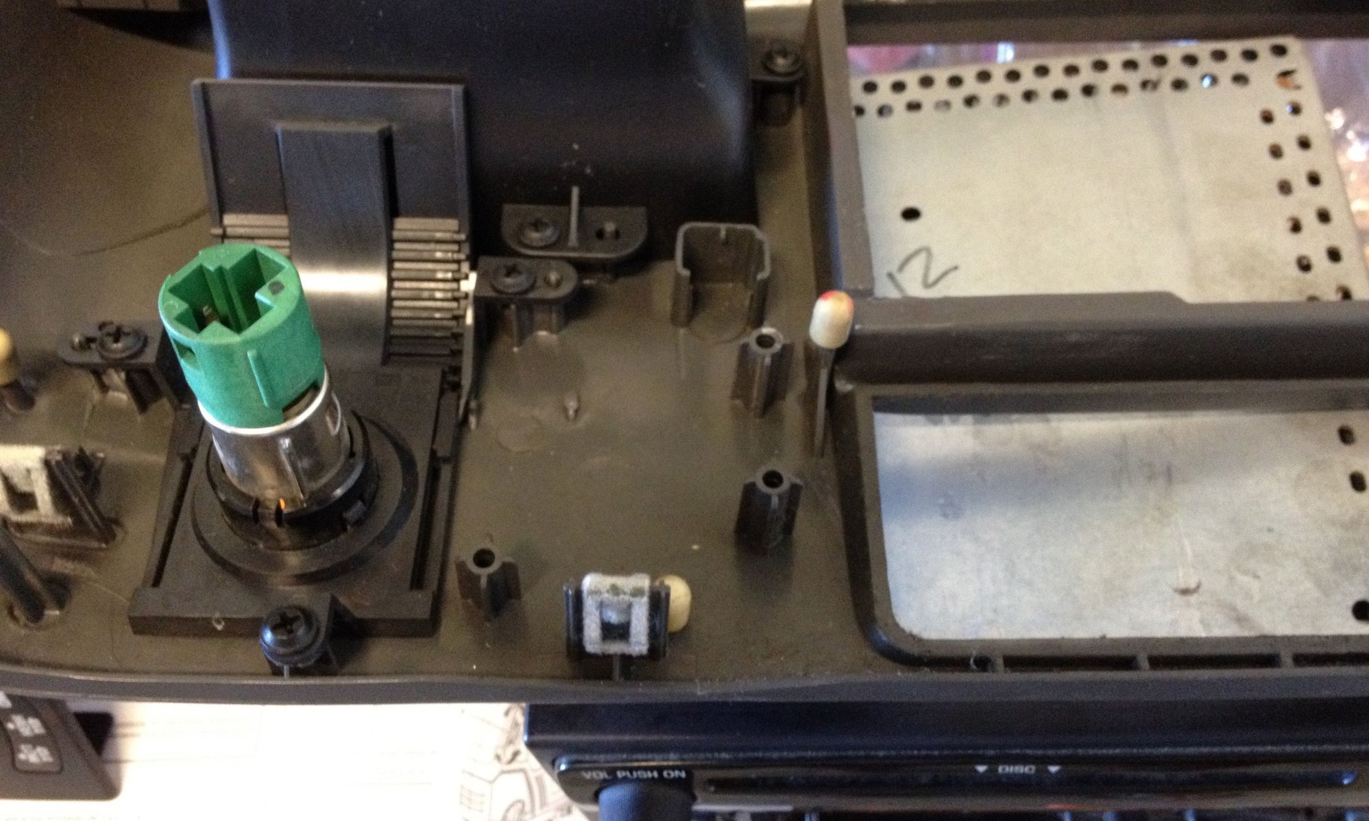

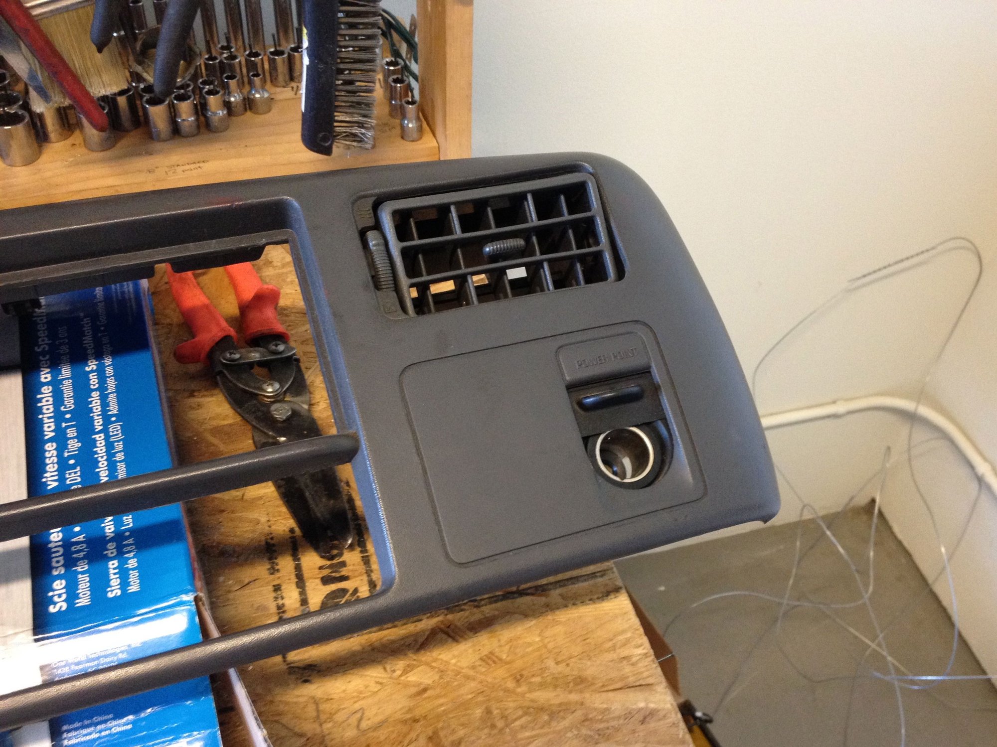

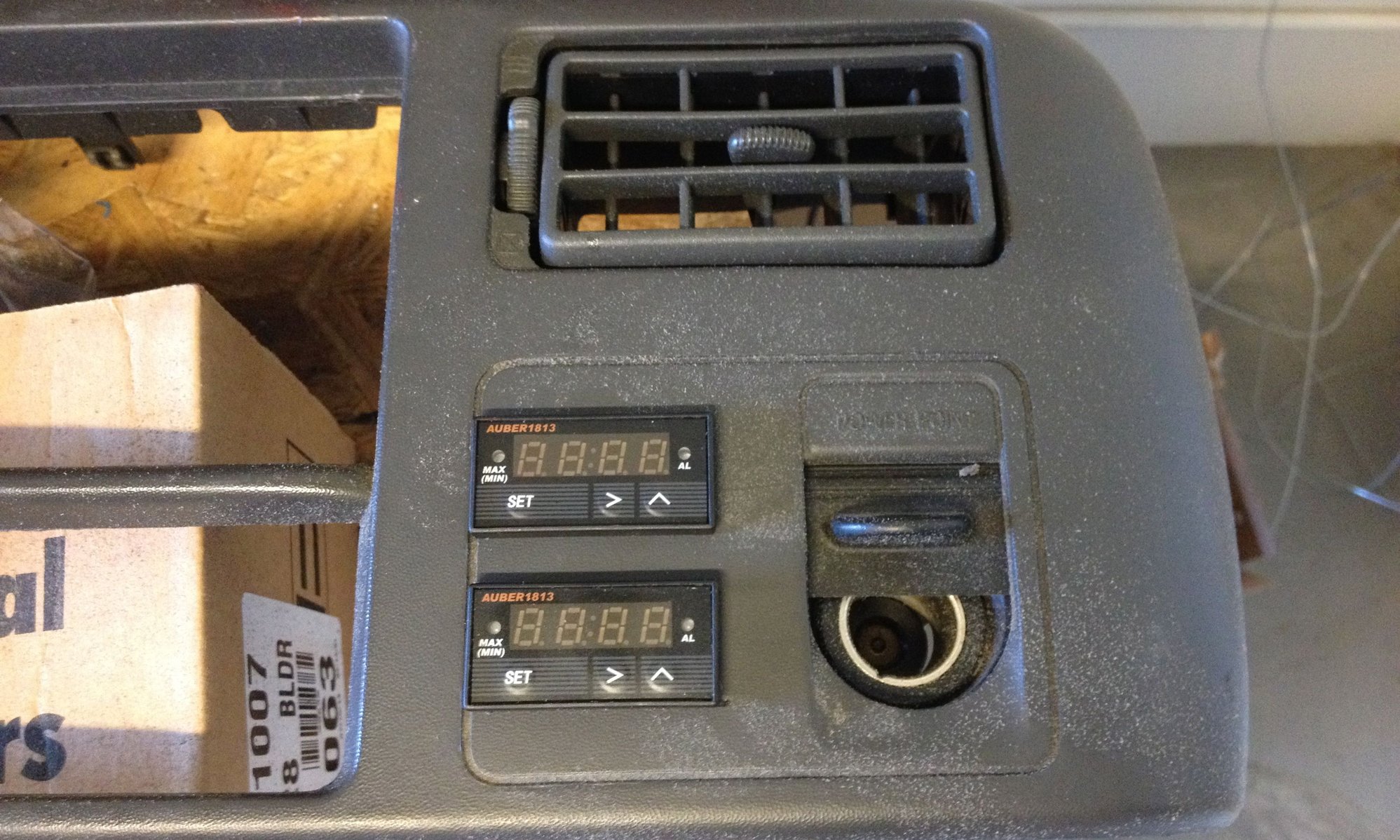

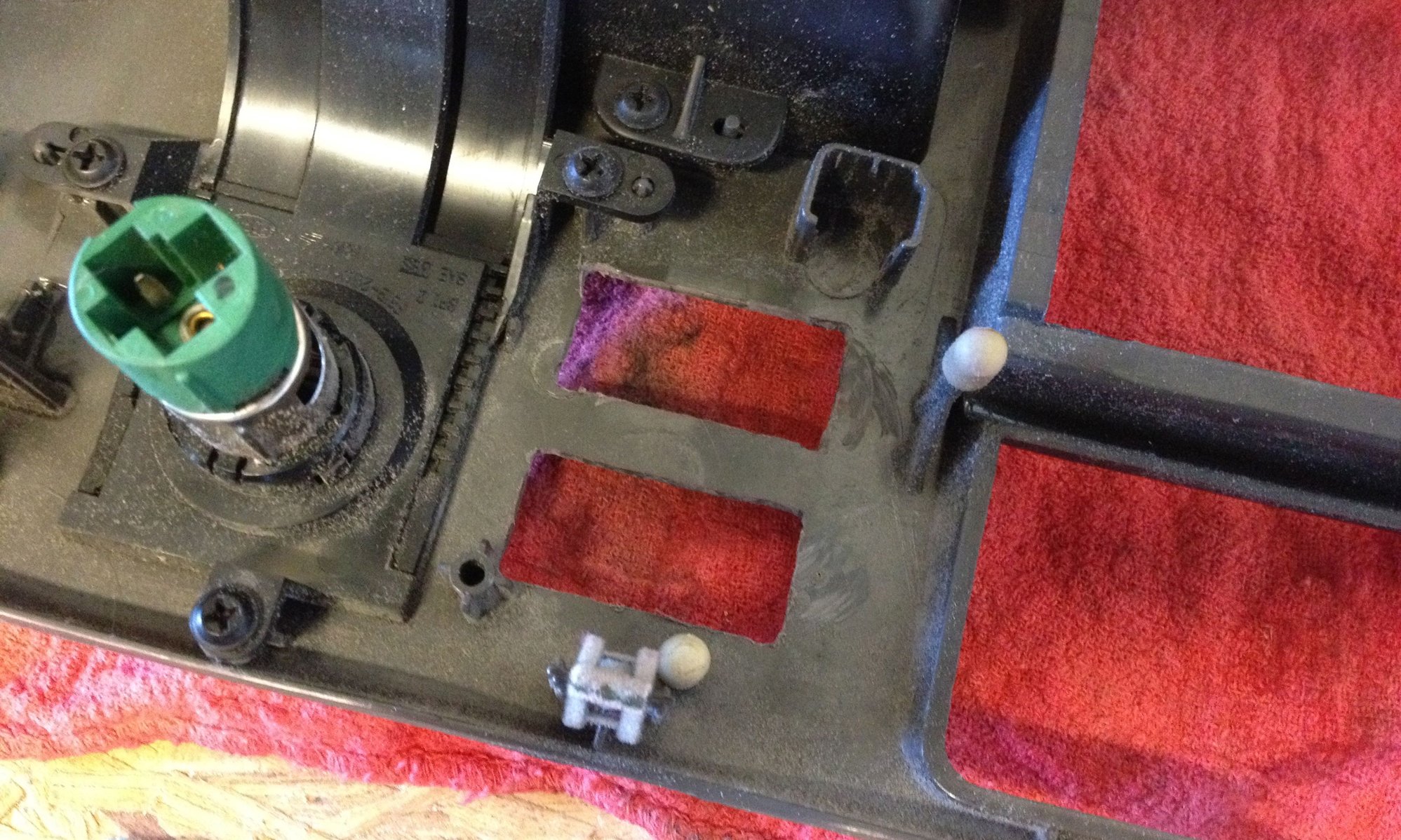

i pulled the dash to make it easier to cut-out the locations for the two auber gauges. i was like you. 'been thinking about it for awhile now…' i just finally had enough and tore into it. pulled the dash, installed a run of wire on the two gauges, ops checked 'em with my 12V battery charger, installing pickup units right now…
here's some pics of the dash process. dremel tool works the best. one thing to keep in mind…? go slowly. a little here a little there, refit the gauge, repeat.

Nice, that's a perfect spot too
