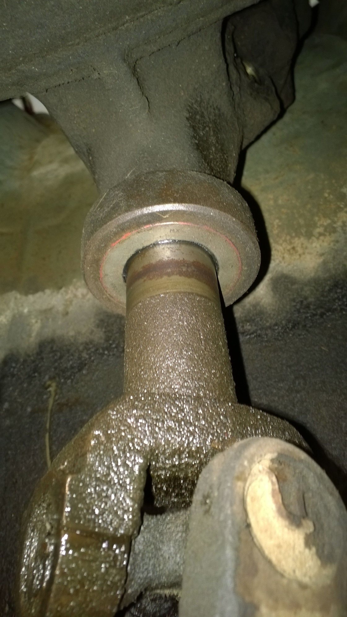

While crawling under the truck to identify my speedo gear, I noticed a oil covering the front u-joint. There seems to be a lot of play in the drive shaft in this area as well. Don't think it is the u-joint, but could be. Never replaced one.
Seems like there may be some front to back play in looking at the shaft as it enters the ....Ok tell me where this is entering. I know its not the tranny.

TAIL SHAFT SEAL is where oil is coming from , might as well do the u joints while you have shaft out for seal replacement

oil leak
You may also have a worn tail shaft bushing, also make sure the slip yoke is not worn. Most of the time these parts are worn due to a frozen front universal joint.

That seal is going to be hard to get out using conventional methods. Don't bother with a puller. Get a screwdriver and hammer it in. Beat the crap out of it. You own't hurt anything.

Yes, pull the driveshaft. Disconnect the carrier bearing and then you should be able to easily pull the shaft out of the tranny. Replace the seal, and then reinstall the shaft in the opposite order.

While the rear of the truck is up the pinion nut is 1 1/16" the seal is not too hard to remove and replace.
With a little research you may be able to borrow a tailshaft bushing removing tool from an auto store or tool rental. Otherwise the tailshaft housing has to come off.

2X Kenny. DO change the tailhousing bushing. That's prolly what made the seal leak.
