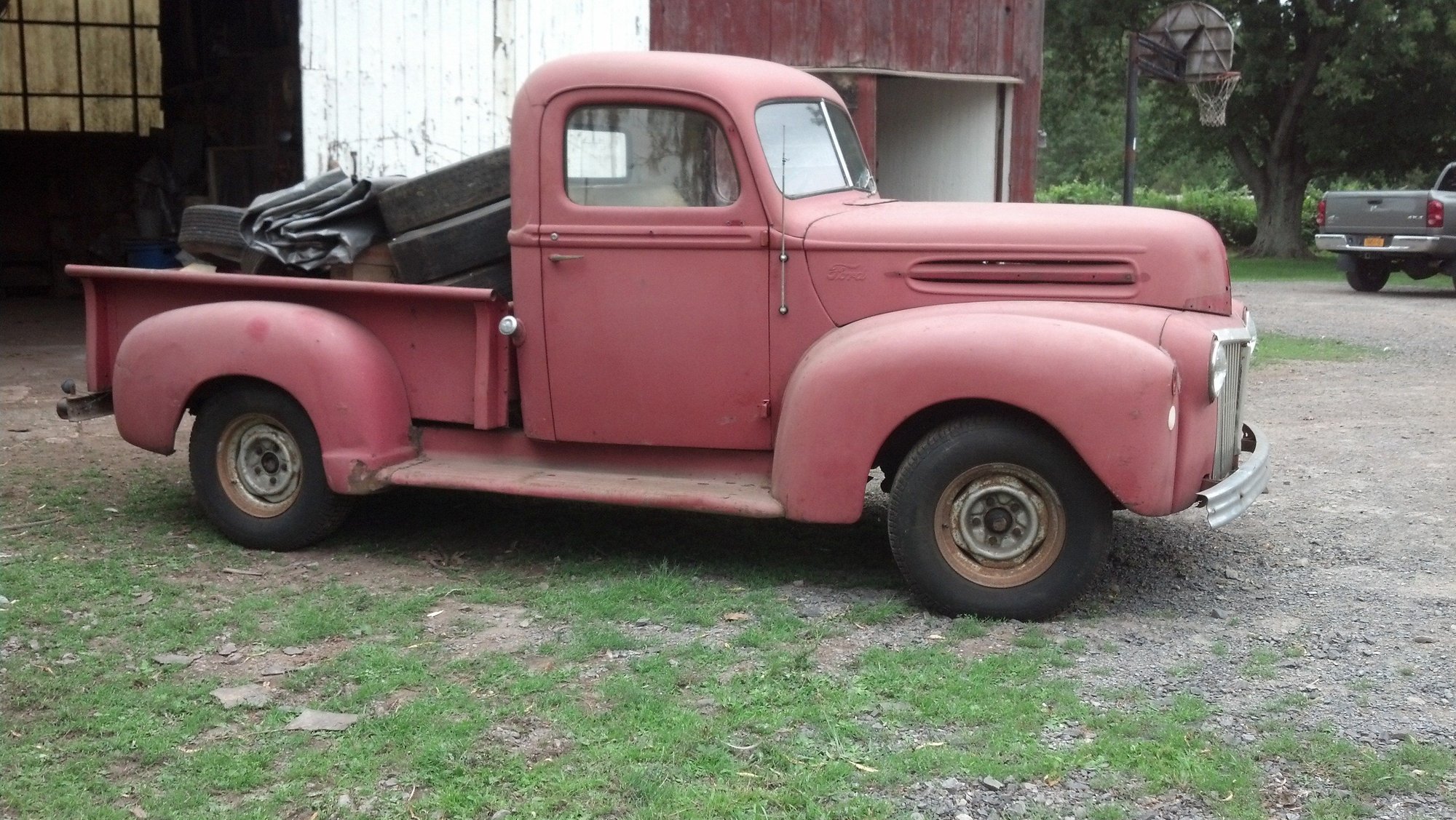

I must say, this site is full of so much awesome information! Let me introduce myself. I am in western NY, right down the road from Mac's. My son and I picked up a 1947 Ford pick up a few weeks ago as a project to work on together. We have restored a few farm implements, and hay balers, but this taking a huge step here. We will have plenty of help from friends that are enthusiast's.
The truck we picked up has been modified a long time ago. It was originally from California, and came to New York in 1970. It needs a complete restoration. There was a modification done to it in the 60's, from what I was told. The truck is solid, but has a few issues. There is a seized 1962 Corvette 327 motor in it, and it has a nice 1952/53 chevy box, rear fenders and tailgate. The truck has been parked in a garage since 1974. The head gasket leaked, and rusted the cylinders a bit.
I look forward to the time that friends and family will spend together on the truck. We are thinking of swapping the bed out with new, adding a IFS and putting a 302 in it. The body is fairly solid, but has a horrible grill modification. We are starting from scratch here, but are eager to get started.

Looks like you got yourself a nice solid start there. I like your plans. It will look much nicer with a Ford bed. The Chevy beds are too shallow looking. As for engine choice, very nice. It's kind of tiring to see a Chevy in a Ford, no offense to anybody that goes that route. Post more pictures as you can

Thank you. We will start by pulling the bed and motor. I am hoping to be able to sell the chevy bed and fenders. It is in nice shape. The block might have worth if someone needs it for a 1962 corvette project motor; I hope we can move that too. I find that pictures are indeed worth 1000 words, especially typed words. We will make sure to post them. This will be a long project, we will work on little things while saving up money for the big things.

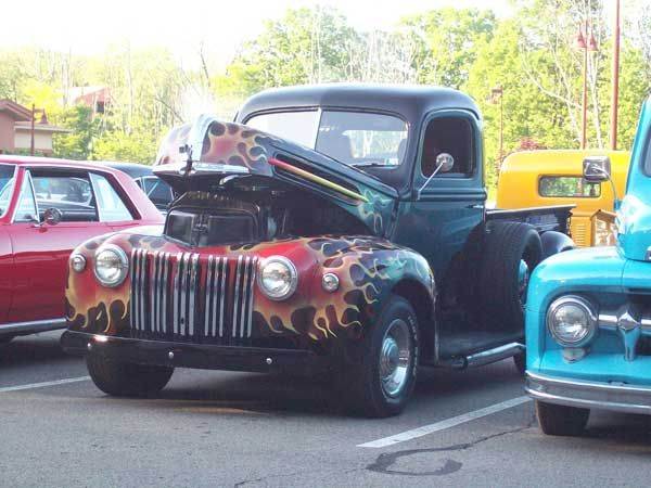

Here's a pict of the Fatman IFS and the tubular motor mounts (you can sort of see then) - They don't get in the way of anything and I'm running a 550+ HP 427.. I did have to get beefier springs from Eaton, but the ones from Fatman will be more than enough for your application.

That looks great! How much did the Fatman IFS lower the front end?

With the heavy engine, my front bumper was 4" off the ground, with the new springs it's about 9".
Before..... & After...
