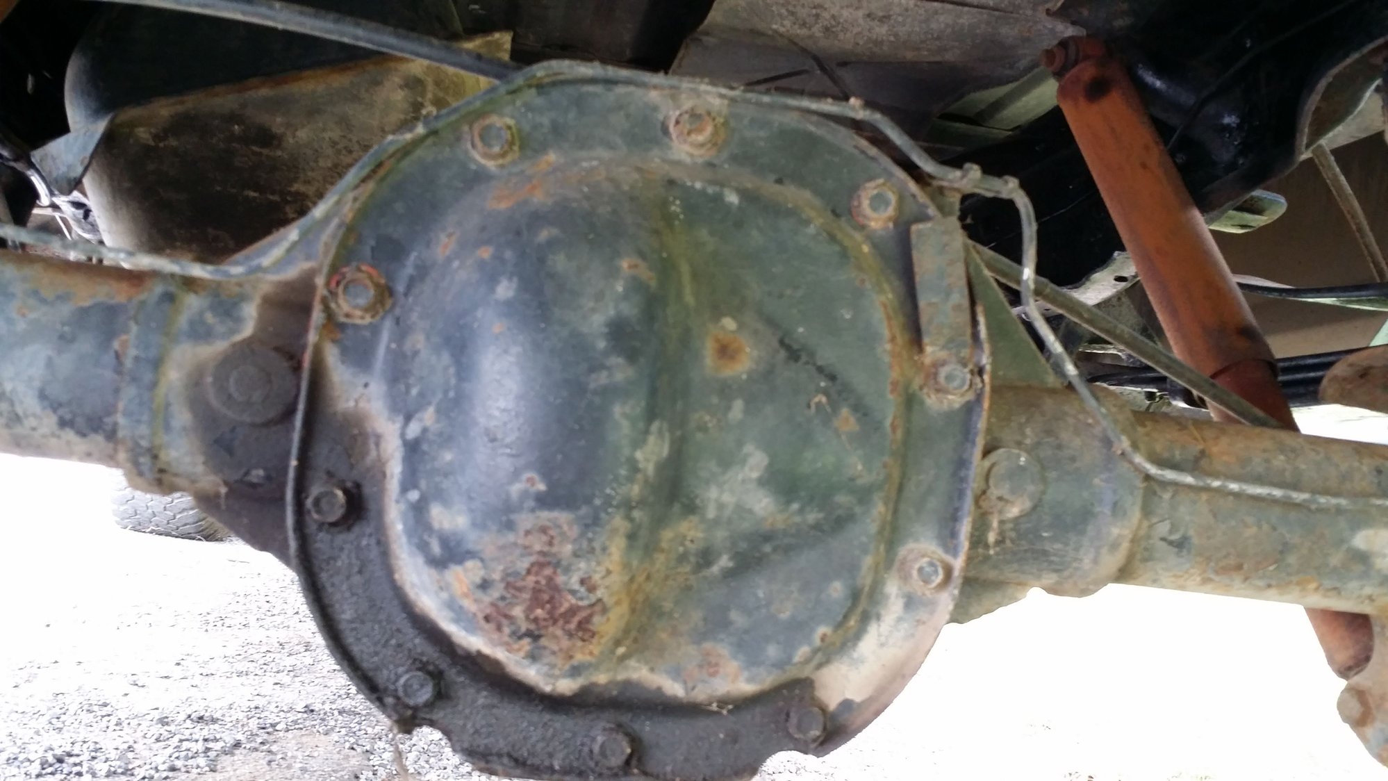

I don't have the measurements for each application. 4x4 will make a difference of course. The type of transfer case if you have 4x4 will make a difference. Overall length of the truck will make a difference.
Do you have 4x4? What is your wheelbase? What rearend do you have? If it's smooth on the rear with no bolts showing, it's a 9 inch. That can make a difference also.
Write back in and we might be able to look it up on a junkyard site.

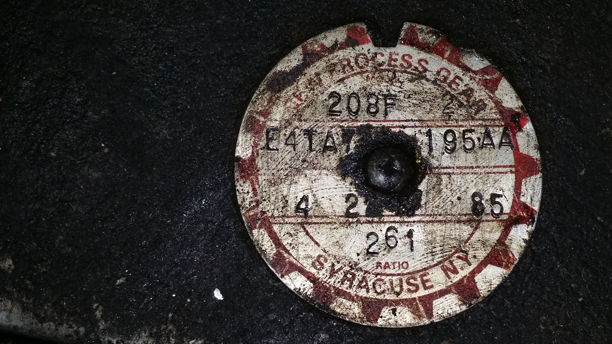

Old Jul 14, 2014 | 12:06 PM
1983f150smitty's Avatar
1983f150smitty
Joined: Jul 2014
Posts: 20
Info of that truck if this helps

Old Jul 14, 2014 | 12:10 PM
1983f150smitty
Joined: Jul 2014
Posts: 20
Rear end

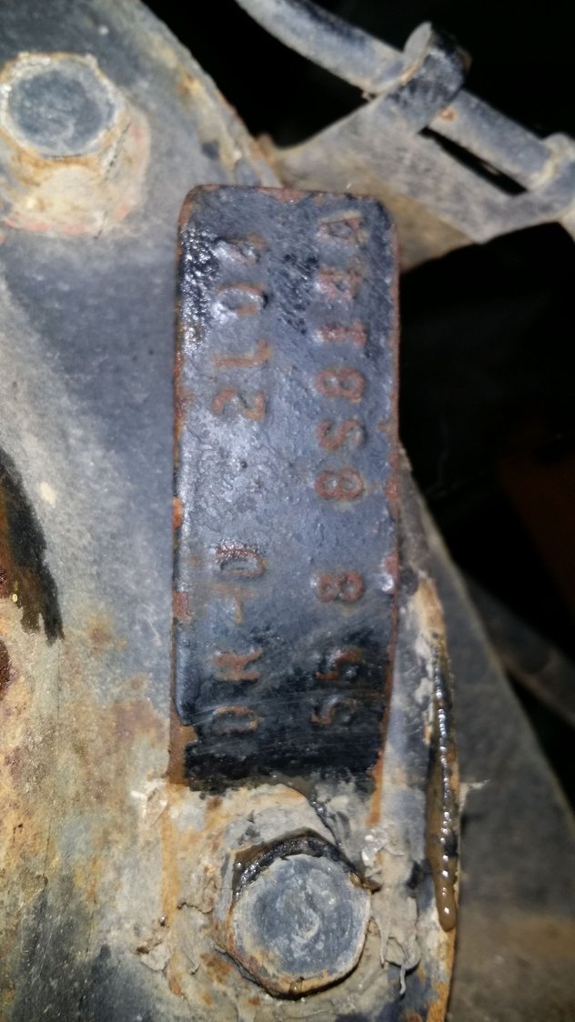

Old Jul 14, 2014 | 12:11 PM
1983f150smitty
Joined: Jul 2014
Posts: 20
Rear end tag

Old Jul 14, 2014 | 03:05 PM
Sw1tchfoot's Avatar
Sw1tchfoot
Joined: Oct 2010
Posts: 1,199
From: Missouri
You have one of the more common combos to find. Look for any 4x4 two door long bed with an 8.8" rear end and a C6 (I'm not sure if any other transmissions will have the same length). I think the 9" axle has different size u-joints. I pulled a driveshaft from an F150 (89?) with an AOD and the u-joint cap sizes were smaller than the ones that the C6/ZF5 and 9" had. It didn't matter, I just switched the caps on the u-joints. This was for 2wd though. I have heard of others going from a C6 to T19 on 4x4's but I'm not sure about driveshaft length, I just know that on a 2wd almost all the shafts are different.
If you tell us what state you are in someone may be able to point you in the right direction to find one.
