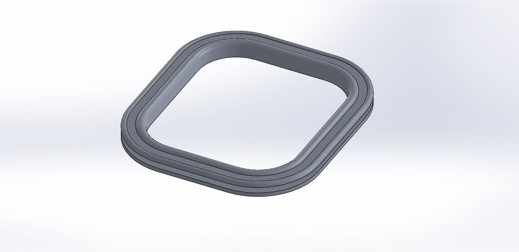

My nephew sent some jpg's back from the 3D CAD work he's done. What'cha think?
Old Jul 8, 2014 | 06:52 PM
first today's Avatar
first today
Joined: Mar 2008
Posts: 3,593
From: Prairieville, La
Put some screws through it and call it done.
J/K
I think it would work well. Seems like it would float with the boot.
Old Jul 8, 2014 | 08:17 PM
5280's Avatar
5280
Joined: Jun 2009
Posts: 510
From: South Park, Colorado
Looks good!
Old Jul 9, 2014 | 10:10 AM
1986F150six's Avatar
1986F150six
Joined: Jul 2009
Posts: 6,477
Likes: 19
From: Sheffield, AL
Impressive and quick, too!
Old Jul 10, 2014 | 11:05 AM
Gary Lewis's Avatar
Gary Lewis
Joined: Jul 2010
Posts: 32,875
Likes: 48
From: Northeast, OK
Yep, he uses SolidWorks in his job, but has just started. We'd had a number of discussions regarding Google's Sketchup, which he had started using in his job. He got me started on it but I couldn't get it to do some fundamental things like a filet. Yes, there are workarounds for that, but they aren't easy and, in my opinion, if the package won't do it then it isn't ready for prime time. So when we talked on the 5th he said the company sent him to SolidWorks training and he now agrees that Sketchup isn't good for serious things. So he was happy to take this on as practice.
And, we talked about another aspect of Dad's truck that he's offered to help me with - creating a gauge module for the pocket to the right of the steering column. The company he works for does a lot in plastic so he said he can get what I need. But, as we talked further he started making suggestions that will help a bunch. For instance, he suggested making a box with a faceplate that just fits into the pocket. And the depth of the box would be exactly the right length to hit the back of the pocket when the faceplate is at the right depth of recess into the pocket. So the screws can go through the back of the pocket into the rear of the box and it'll look like the box was there from the factory. In fact, the company he works for might make them for us.
