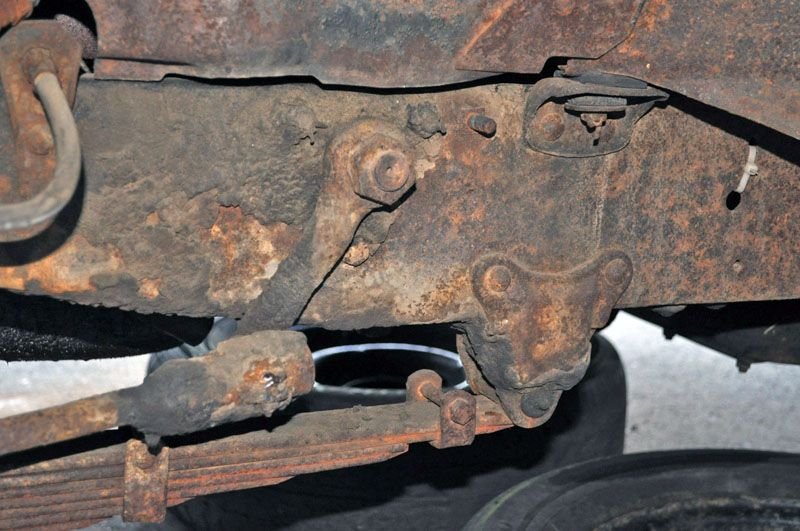

It might be easier said than done. I'm not sure where you are from (suggest adding that to your "details" under UserCP link in top left corner of header) but if you are from the rust belt your pitman arm could be pretty difficult to remove. You can buy a simple pitman arm puller for not much money at most auto parts or tool stores (Pitman Arm Puller). That should help. Try a bit of heat (just short of turning red) if you still have a problem, but be sure to protect what is above what you are heating (wiring, fuel pump, hoses, etc.). I used a piece of cement board.
Rust-belt truck
Pitman Arm Puller
Sometimes it just won't come off.
This gives you an excuse to clean things up and install a Toyota power steering box
