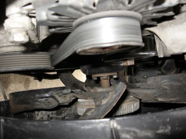

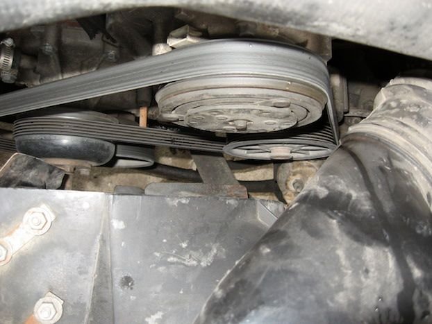

So earlier today I was cruising right along on the highway in my 91 F150 5.8, everything's going smoothly, I'm enjoying the breeze with my 2/55 AC system, and then all of a sudden.....SQUEEEEEEEEEEAAAAAAAAALLLLLLL!!!!!! The loudest, non-stop squealing I've ever heard from an engine.
So I pull over (having just finished a service call for work not 15 minutes earlier, I might add), pop the hood and find that my smog pump is locked up solid, causing the wretched screaming that's now deafening an already hard-of-hearing individual such as myself.
I shut off the engine... Well, now what? ... After a few moments of staring blankly at the engine, trying to decide if I should call for a tow truck or at least a ride back to work, I get an idea.... but wait, those almost never work out! But I decide to try it anyway....
I remove the belt from the smog pump, leaving it otherwise routed normally, and slowly let off the tensioner... it seems to bottom out, but there's tension on the belt! Just barely (and by barely, I mean at least 1.5" of free play in the belt), but it's there!
I hesitantly turn the key - as expected the engine starts, and for a moment, the squeal is there, but not nearly as bad. I look at the belt to find that the smooth side is now lightly rubbing against the smog pump pulley, but everything else seems to be turning normally!
I shut the hood and cautiously pull back onto the road, hazard lights... hazarding... and very closely observe my gauges... ... voltmeter, normal.... ... temperature, holding steady... ... oil pressure... pfff! That gauge hasn't worked in a year! And besides, the oil pressure gauge doesn't run off the s-belt, dummy!
I managed to get back to work (and along the way, stop by the parts store and order the new pump as tomorrow's project ), finish my day, and drive home - all with the s-belt routed off the smog pump! The alternator, water pump, and power steering all worked just fine! I checked the belt when I got home and I'm gonna replace it anyway just to be on the safe side, but there's hardly any wear on the smooth side of the belt. It's obvious where it was rubbing against the smog pump pulley, but otherwise my truck ran "completely normal" with the belt routed that way.
I'll try to get some pictures before I take it apart tomorrow, but I just thought it was really interesting that my truck ran normally with the belt routed that way. I never would have expected enough tension on the belt to make it happen.

Yeah, I think the set up of the pulley's and it being the smog pump is the only thing that made it possible. I don't think any of the other pulley's failing would have allowed for it to work....
Like I said, I'm gonna replace the belt anyway just to be safe, but it (surprisingly so) held up very well and even though it's obvious it's been rubbing, it doesn't look damaged.
