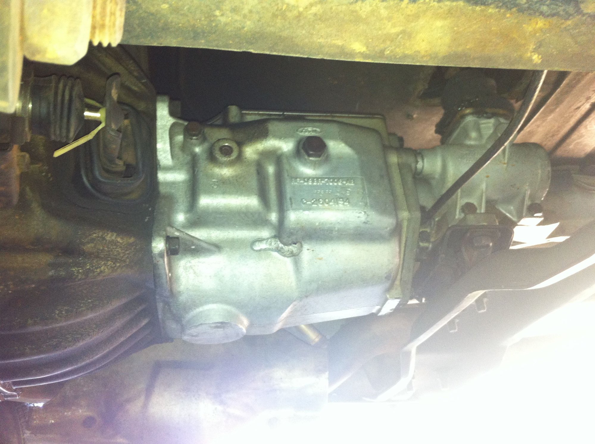

Hopefully someone out there has a list of part numbers or something where we can find out what transmissions are installed by the numbers.
So Ive got a 3 speed with OD. its not the trans that came with the truck so Im trying to figure out what it is.
Any help here would be wonderful. Maybe a reference I could research myself or something.
Here have a pic

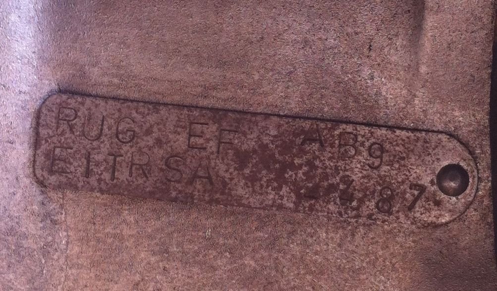

And here is the other tag on the other side.
To me it looks like it says:
RUG EF AB9
EITRSA 4487
I hope that makes sense to someone out there lol

RUG EF
E1TR SA
Seems to mean 1981 F100 or '82 F100/150 300 I-6 4x2 driveline application.
Looks like a welded repair in the first pic, too.
Chris just posted all the transmission listings in post #70 of RL250's 331 stroker thread.
https://www.ford-trucks.com/forums/1...l#post14420692
Have a look

Does it have the shifter levers on the outside of the tranny? If so, that's the tranny that is related to the old toploader tranny. They turned the 3rd and 4th shifter lever upside down, so in 3rd you are really in the old 4th spot which is 1 to 1, and in 4th you are really in the old toploader 3rd gear, and they changed these gears to give it overdrive.
The other tranny sort of like this is the SROD and it has the shifter built inside the tranny, no outside levers and linkage rods.

Tail shaft top loader no external linkage it looks like. heres a pif of the side of it.

A couple of excerpts from Fordsix:
Model: T170FS/RUG or SROD (single rail OD)
Manufacture: Tremec
Type: Four speed overdrive w/ push down reverse
Years: 1980-83
Truck:
Engines: 300, 302
Construction features: Aluminum, synchronized in forward gears, shifter near back
Trans code: B
Gear ratios: 3.07 1.72 1.00 0.70
T170FS (Code-RUG)
Also known as Single Rail Overdrive (SROD). Has an aluminum case with shifter turret mounted on extension housing. Synchronized in all forward speeds with 4th being overdrive. Used in Ford light duty pickup trucks 1980-83. There is also a passenger car version of this unit with lighter duty bearings and gear ratios. Produced in 2 and 4 wheel drive versions.
I don't know much about them except people feel they are better than the M5OD
