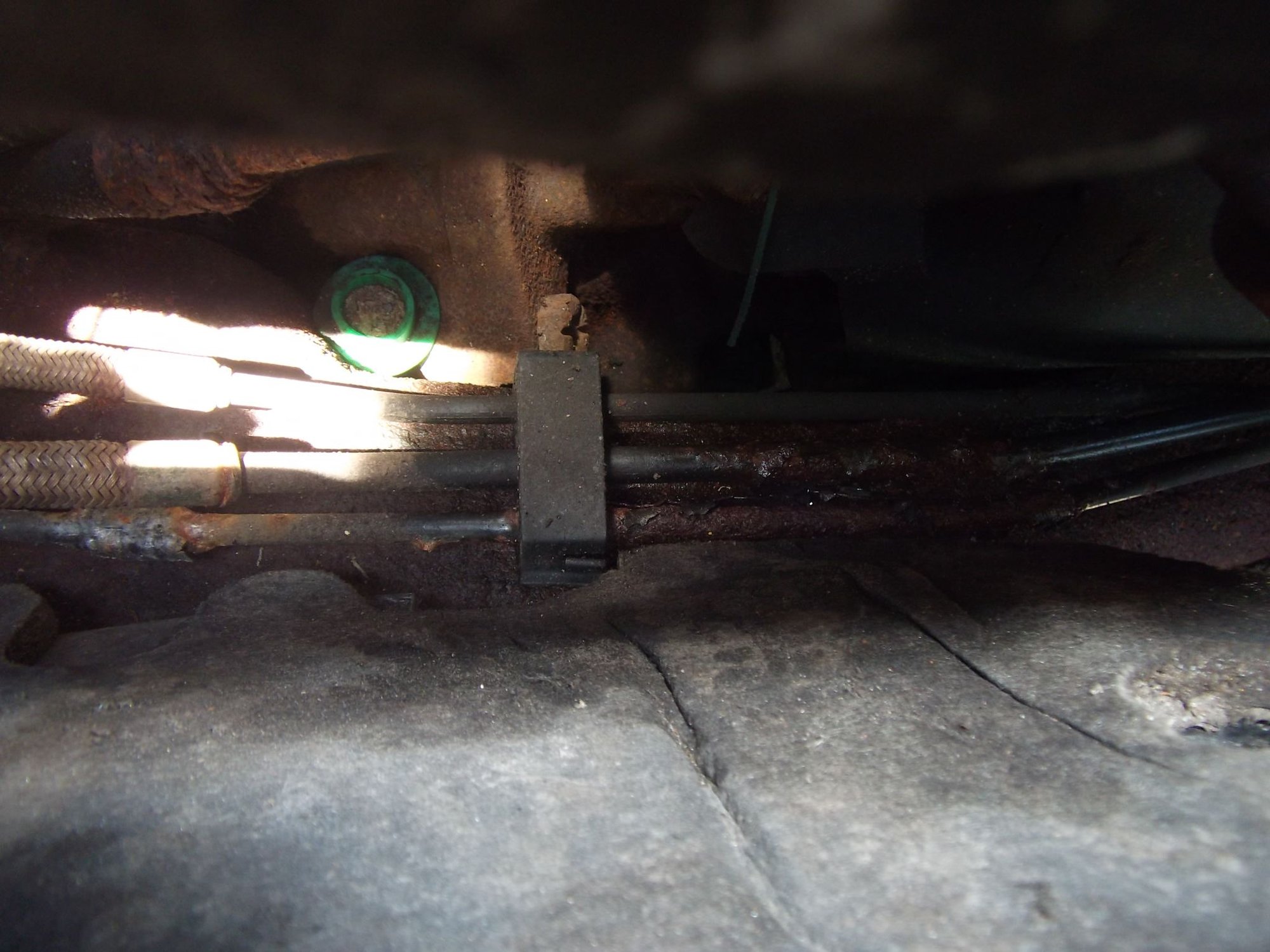

well, found the leaking brake line, and i only had to take half the truck apart.
all 3 of the lines with the braided flex line in them going to the ABS unit are corroded rite above the front axle.
fun fun.

the funny thing is, the brake lines on this truck are all in perfect condition. except for this one spot.
ford opens in a few minutes and i will find out the damages to the wallet. i am assuming the one next to the engine is passenger frontr, the large one in the middle is for the rears, and the one closest to the fender that is leaking is the driver front.
if the price is outrageous, i am just going to do a alloy line patch to the rear line. but the one closest to the fender has to be replaced, besides the leak it is severely corroded rite at the flex section and can not be patched.
