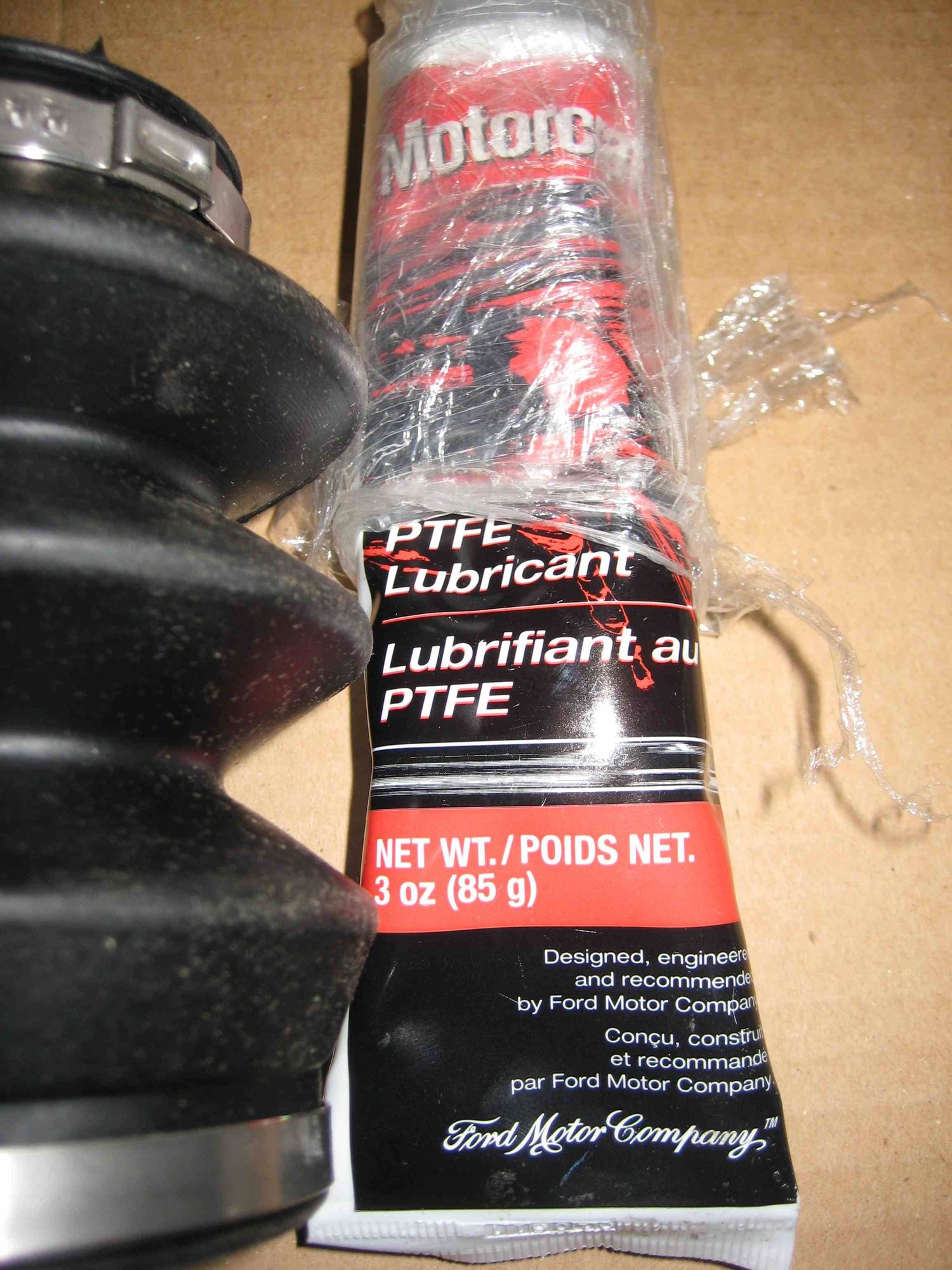

I finally got the slip yoke out with a hammer(finally). Now, what is the blue coating on the shaft? Also, can I use synthetic grease to put it back in? Or is there a special grease (light duty) that I should buy from Ford?

There is a special grease.

The blue is the coating on the shaft. I don't know what the special grease is but I've been using bearing grease for 7 years and things seem to be going okay. I usually have to pull the yoke apart, clean it out and regrease it once a year or so (when I start to feel the clunk-clunk-clunk on take-off).

Originally Posted by Y2KW57
Ford has a special PFTE lubricant they specify for slip joints.
Originally Posted by Vijay
"is there a special grease (light duty) that I should buy from Ford?"
My first response to your thread, re-quoted above, might have "slipped" by you.
So here it is in black and white:
And, in living color:
