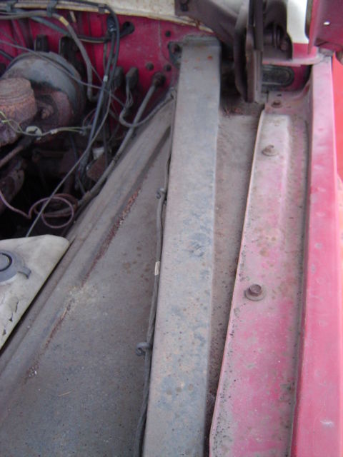

I've never run across a zip tie used on the apron on my 1966 trucks. Works great for bundling wiring. But the apron had a different retainer for the wiring that also hooked into a series of holes in the metal.
Here's an untouched example that uses the type of retainer that I posted.
I didn't say the zip ties were correct. Member in post 2 said he saw them in a repro parts sellers catalog, but couldn't recall which one. So I listed the DC info.
As I recall, most of the wires are retained with metal clips that have a loop in them, loop contains a rubber insert. Retained to apron, firewall, radiator support with a screw or bolt.
