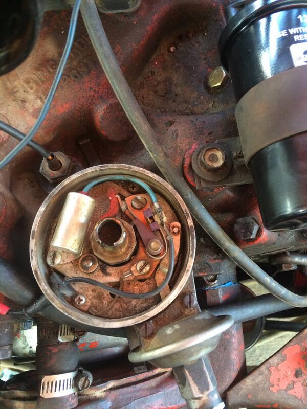

How's the points? Condensor?
Old May 2, 2014 | 11:51 AM
jesseh39's Avatar
jesseh39
Joined: May 2014
Posts: 47
I go look... and take picture...
Old May 2, 2014 | 12:21 PM
jesseh39's Avatar
jesseh39
Joined: May 2014
Posts: 47
yeah, im a broke basic member, and cant take pictures... I have it here, but ant figure out how to post it, twitter maybe? lol but the thin steel arm is touching the nut, the gap opens and closes, but the felt is off a little bit..
Old May 2, 2014 | 12:24 PM
jesseh39's Avatar
jesseh39
Joined: May 2014
Posts: 47
http://t.co/v88rwv97h9
