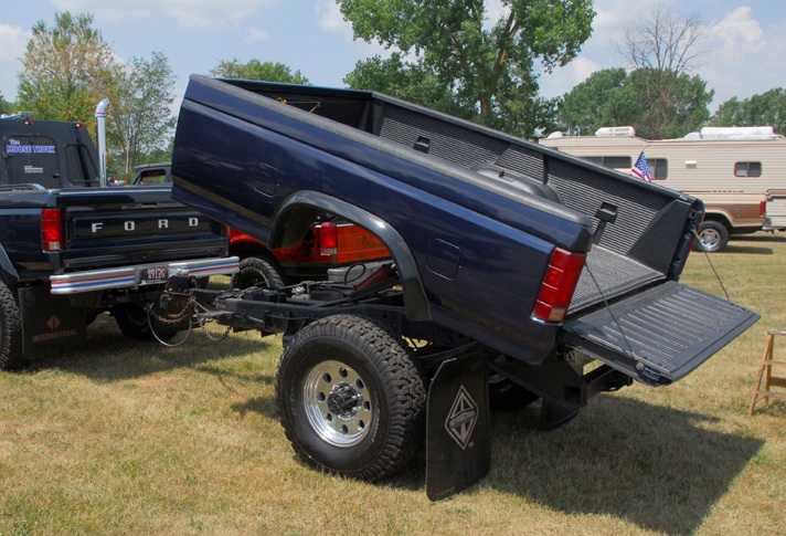

Like your thinking...
Old Apr 13, 2014 | 08:42 AM
LivingLarge's Avatar
LivingLarge
Joined: Feb 2011
Posts: 26,410
From: Ft. Lauderdale, FL
Looks like they just cut and modified the frame...
