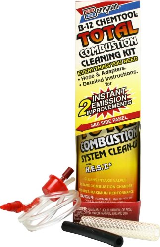

I've bought this kit awhile back and it works well.
Sir, did you buy this from one of the auto part chain stores?

You said you reconnected the intake! Normally leave it disconnected and run the engine spraying the throttle valve and down into the opening of the TB. Spray in before starting to begin the process. Start then spray as the engine runs!
As to the kits, just use seafoam or the type above and stick a hose into the can and it will suck it all out. Autozone has/had the SF for about $6-7 a can on sale. The other stuff is generally a $1 or 2 less than the SF and works almost as well. Run the can thru and then leave off for about 30 mins.
Yeah I bought it at autozone.
