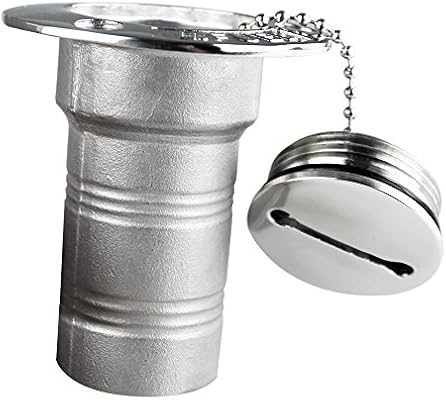

BOOM! If I had truck in garage outta the rain I'd install tonight but meh..
Amazon parts
Needa parts 800-015 Fuel line clips 6 pack (3 5/16, 3 3/8) $8.35
Gates 23932 Fuel fill hose 36"/3 ft $55.88 ×2
Salty Reef Marine Hardware Boat Deck Fuel Fill/Filler with Key Cap -2"- Diesel or Gas Marine Grade 316 Stainless Steel $29.99 ×2
  1. "><img src=" /> ">
Ford fuel vapor valve E7DZ-9B593-A $48.49
Mid tank Spectra FD6 (Amazon said part wouldn't fit but works well. Each sender has 2 down tabs in which I just had to shave 1 with dremel for fitment of sender unit in mid tank) bought used $60.99 , new is $84.73
Rear tank Spectra F26E, Amazon also said won't fit, worked fine for 19 to 38 gallon conversion $143.78
Ebay
Side tank sender TREX AUTO part #TREXFMSU-6DE $83.95
Rear tank sender TREX AUTO part #TREXFMSU-6DER $83.95
8 injectors 6.9l 7.3l IDI FUEL INJECTORS 83-94 from accuratediesel (26273) 99.8% $195.99 + $80 refundable core
