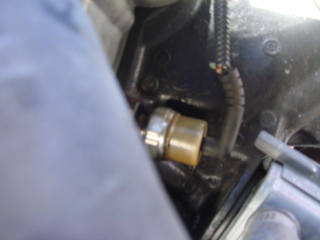

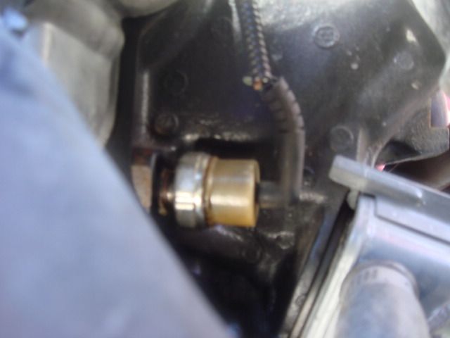

Question what is the sensor located on the drivers side of timing cover, looks like a larger version of a temp sensor?

the sensor on driver side timing cover is the crank position sensor if i recall. can you post up a pic?

Here are several pictures of the sensor in question, located drivers side front timing cover.

that looks like the oil pressure sending unit.

Ok that is correct, Thanks.
