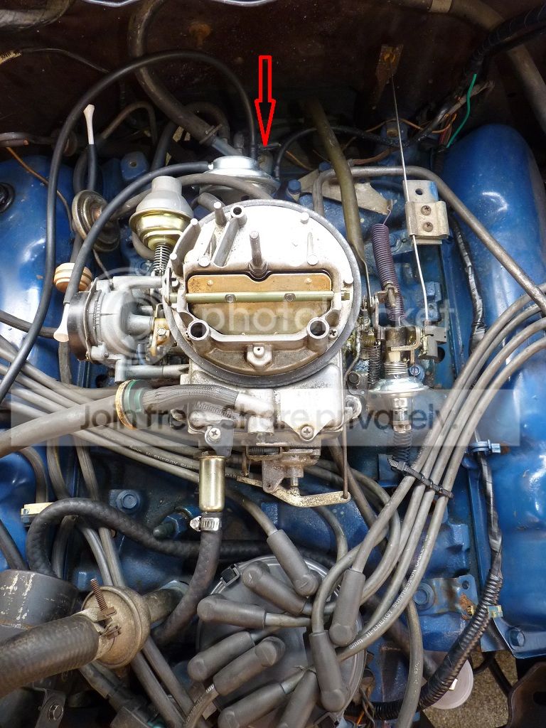

As far as the EGR.....their is a booster looking thing the size of the bottom of a pop can behind the carb by the firewall that has a plugged vacuum line. Is that the EGR? and what does this do?
Correct that is the EGR. It stands for "exhaust gas recirculation". It basically is for emissions as its job is to take some of the exhaust gas and pump it back through the engine. Is it NEEDED? Well, no. You CAN remove it, but you MAY have to retune your carb.
The EGR valve recirculates a metered amount of exhaust gas into the intake in order to reduce combustion chamber temperatures, resulting in reduced NOX (nitrogen oxides) emissions. The EGR valve remains closed at idle and during heavy acceleration, opening during cruise. Disabling the EGR system will result in higher combustion temperatures, often leading to predetonation (pinging).
