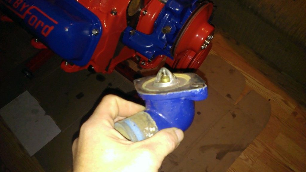

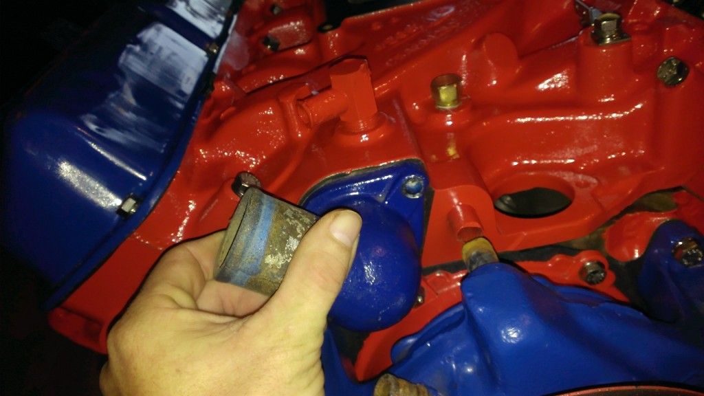

Originally Posted by JEFFFAFA
3X on the thermostat. Besides it probably being the problem make sure you have a quality one in there. No China crap. And I don't mean to insult you but, make sure thermostat is installed with the spring side down towards the hot coolant in the engine. NOT pointing up at the thermostat housing.
You got that backwards there bud.......
Yeah, the T-Stat in these pictures is installed backwards.
Uh, no it isn't........
I knew you would come up with something comical there Area. I'm just waiting to hear what Hio's gonna say!

Tis back assward all right!!. The spring goes into the manifold..
