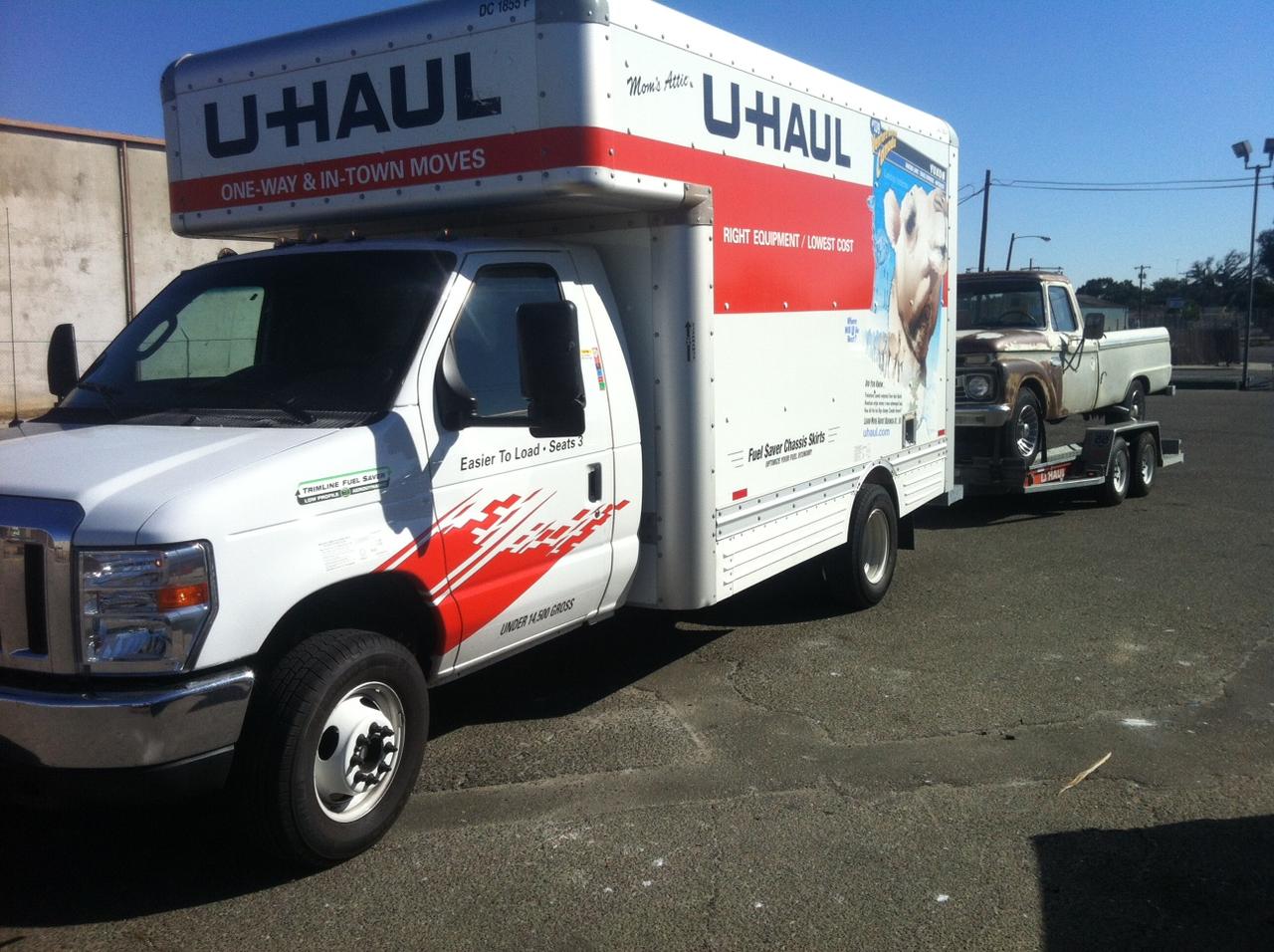

When I brought my '66 lwb back from CA the uHaul place wouldn't rent a trailer to haul the truck that was small enough to be allowed to tow behind one of their pickups. So, I had to step up to a 14' box van to get the trailer I needed. And the trailer was just barely long enough to get the back tires on and the ramps up as it was, with the bigger trailer, so I'm sure they were right. That trailer was too heavy with the truck on it to pull behind an F100 comfortably I'd bet. Even with this setup if I got over about 60-65 it would start to fishtail like crazy. Anything is possible, but that's what I ran into.
