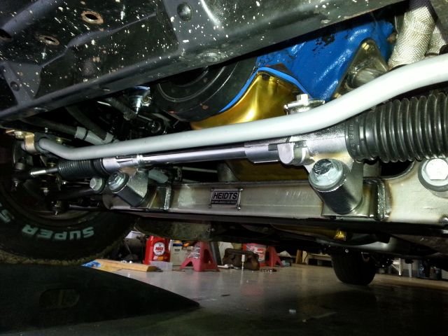

I got the front end pretty much wrapped up for good over the weekend, bearings are packed and it's all painted.
Still need to mount the front sway bar and install all the grease fittings in the ball joints and tie rod ends
I touched up the main frame rails with black but taped off the new crossmember and clearcoated it, the A-arms, and the knuckles to contrast it against the black.

The truck is finished...for now at least..., however I can't drive it because it's now so low that even a 1/4 turn either way starts ripping rubber off the edge of the front tires so a better fitting set is in the works.
So in the meantime here's a few more pictures.
The new radiator, shroud, and flipped fan.
I simply couldn't cover up that nice logo on the crossmember so that's all clear coated as well, the bottom is simply black.
You can also see my now non-leaking Milodon oil pan, I should've never skimped on the pan the first go around because there's truly a reason you pay for quality and fitment.
