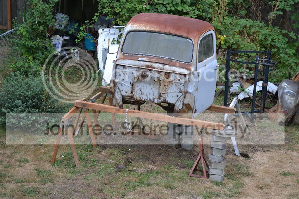

We have the bed and front clip off the F1 in the process of stripping it to the frame. Next is the cab, and therein lies the question.
How much can we expect the cab to weigh? We will probably try to muscle it off the frame and are trying to figure out how many people we are going to need. We have a four point lift, but have not come up with any good way to use it in lifting the cab.
Any thoughts would be appreciated and thanks for looking.

I would strip the cab before lifting it off, meaning doors and seat out at minimum.
Get a cherry picker. Put a 4x4 inside the top of the cab, then attach tie downs on each side of the 4x4 through the hook in the cherry picker and lift up the cab. Make sure to balance the cab before lifting.
Also, a minimum of two strong guys can lift the cab, but three to four is ideal. The front of the cab weighs more than the rear.

My son and I lifted my cab off with doors attached. It wasn't that heavy, but when we put it back on the doors were off of it and it was much easier. Doable with 2, but 3-4 makes it easier.
I had a pallet with 4 casters waiting for it to rest on as a work stand.

The cab is light once the doors are off, I accomplished this by myself with a cherry picker.
