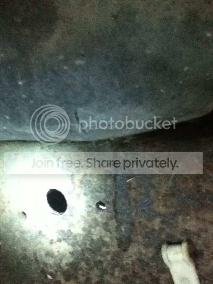

My dad cracked his frame on our 85 years and years ago after heavy abuse. It cracked on the passenger side, on the top of the frame rail about 8 inches down the frame rail after the shock tower.
A big fat thick weld will hold if you go up and down both sides. It's held for years and years and you almost wouldn't even know it cracked. You can see the old weld below.
