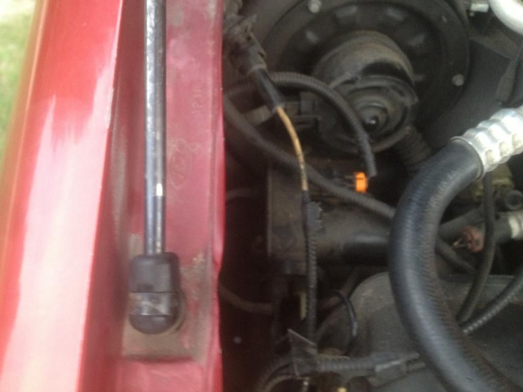

it has all new pistons and rings, bearing, lpop, arp main studs, arp head studs, main stud girdle, new 165cc single shot injectors, new t500 hpop, new water pump, two new batteries, new alternator, new camshaft sensor, new injector control pressure sensor, new valve cover gaskets, pigtails, gpr, glowplugs, fuel crossover from riffraff, new water temp sensor, new starter solenoid, new turbo (38R) 6position chip programed by riffraff diesel, I crank over the engine but my check gauge light stays on and battery light does too, there is no air in fuel lines, fuel goes up to the bowl fine, all the fuses were good, when I crank it over there is a black box behind the passenger side battery that is vibrating and clicking when it is cranking over. if someone has AE near point harbor nc or virgina beach and could help me please I need help badly. I can pay for gas to come and a little money to help test it. the oil reservoir is full. im not sure how to put pics on here but if you can help ill email a pic of that box I was talking about.

The "box" sounds like you are describing the vacuum pump.

do you have an email I could send pictures to you if you don't mind. if not that's okay. I actually believe you replied to my last post too, so thank you for your time and help.

Got your message, that is your vacuum pump, I will post the pics in just a second.

just sent the email to you. thanks for the help.

Here they are, like I said, it's your vacuum pump.

thank you, will a bad vacuum pump stop a truck from starting? will it effect the battery or charging system?

The only way it would keep from starting would be if the battery voltage was dropping below 10V or so while cranking.
Is it running all the time or just while the key is on?
If you have a vacuum leak, it will run when there is a demand. Could be a leak to the ESOF hubs or to the A/C vent controls.

It just vibrates and makes a really bad clicking sound when the key is on, and my battery light stays on all the time with two new batteries and a new alternator. tight connections on terminals.
