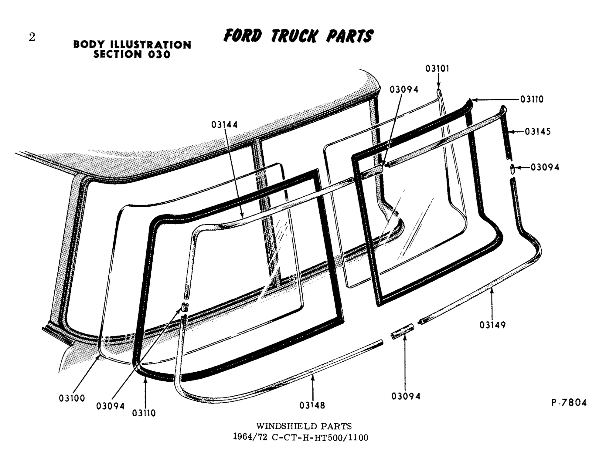

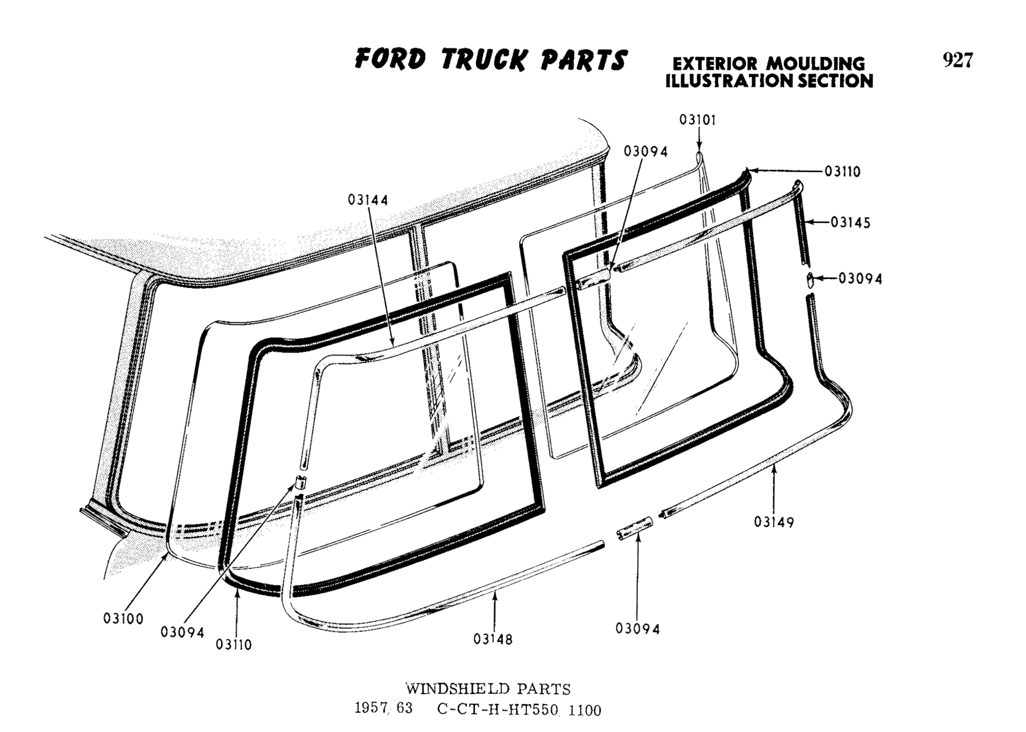

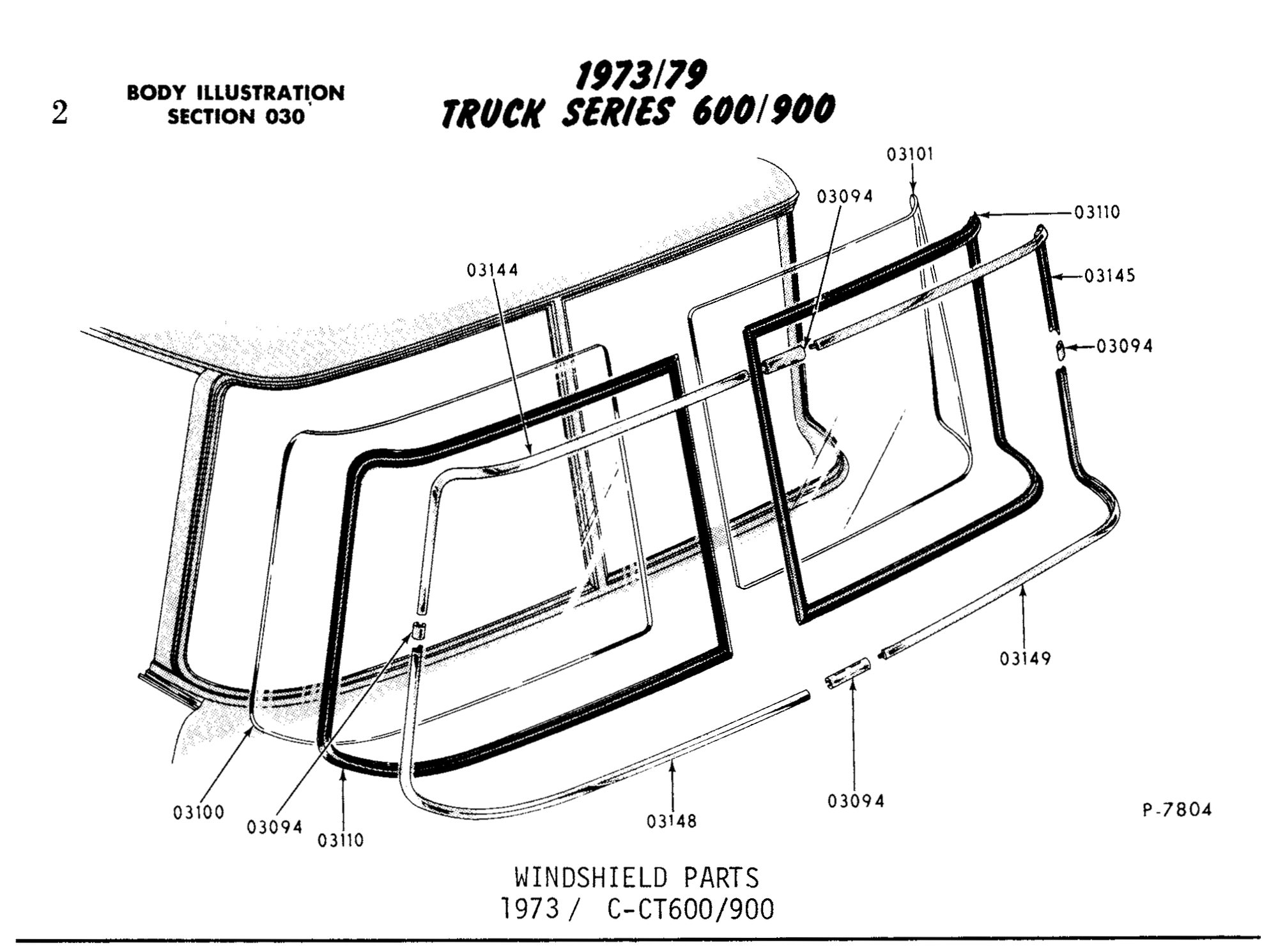

I'm putting some info on C-series windshields here.
MPC 1957-63:
MPC 1964-72:
MPC 1973-79:
MPC 1980-89:
As you can see, pretty much the same.

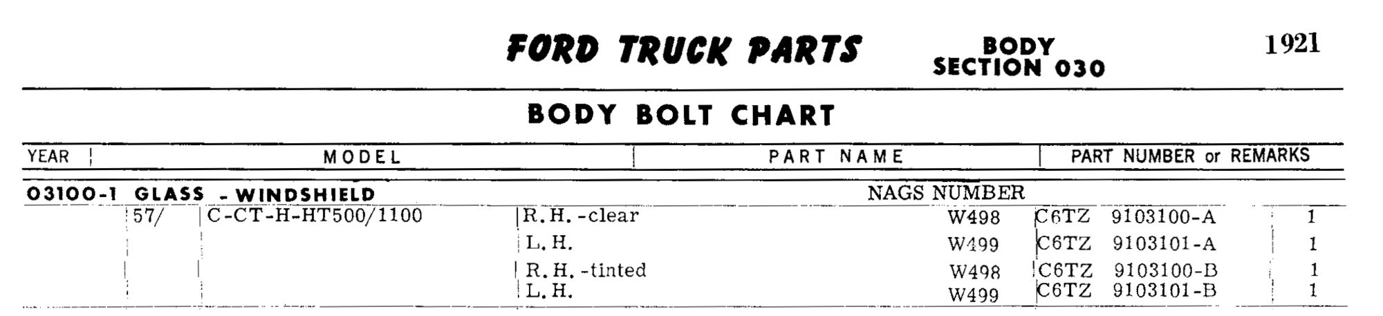

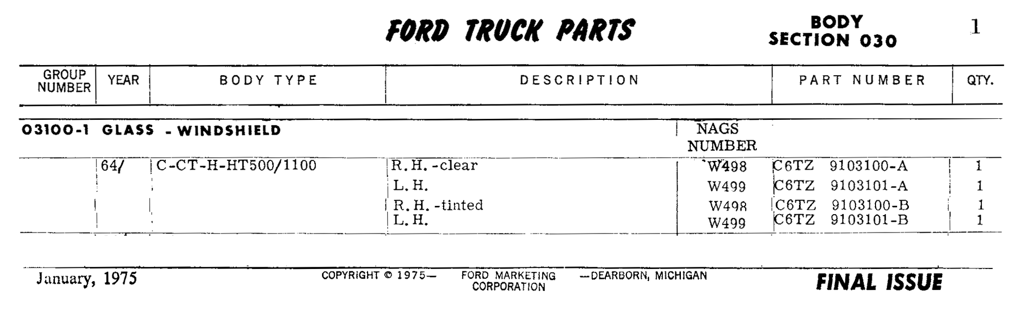

MPC 1957-63:
MPC 1964-72:
MPC 1973-79:
The same NAGS numbers until '73, then different numbers after a certain Ser. No.
(specify clear or tinted)
Right: W498
Left: W499
