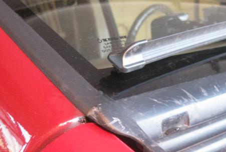

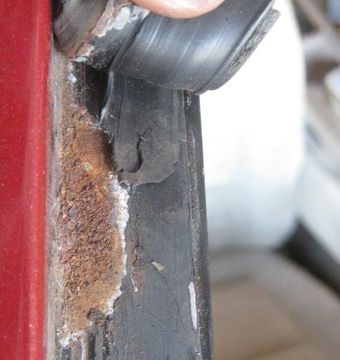

The windshield on an Aerostar was re-installed. The windshield had been dripping occasionally for several years but suddenly became a big problem in a big storm.

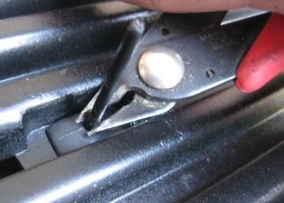

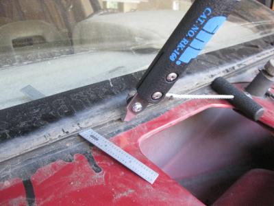

I was all set to cut out the windshield with an angle blade on a pull knife, but in many places the screen had already detached from the adhesive. A straight blade would have probably sufficed. Note that glass will have a black border that you don't want to scrap off, else you will see the adesive thru the glass.

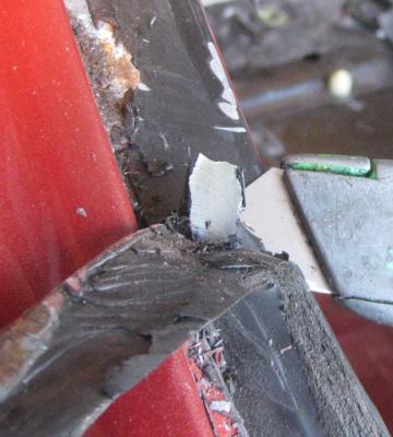

Here is the other set of trouble. The old adhesive was not bonded well to the sheet metal, instead creating a perfect habitat for rust.

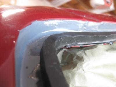

The rust was brushed down to metal and the van prepped for catalysed primer, the gray stuff in pics below.
A square bead of double-sided butyl rubber creates a dam for the adhesive and positions the windshield at the correct level. The original install used 1/4 square, but I guessed correctly that 5/16 would be the better choice, placing the windshield either flush or just slightly proud. CRL FD312R.

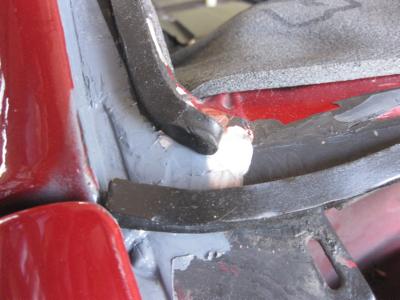

The new weatherstrip was immediately embedded into the adhesive. Triangles were cut out of the inside corner. Awkward, but much better than making no cuts. On the original install the inside corner flared up into a scoop, forcing water down into the channel. Pay attention to sealing that junction with the roof channel. Uncured adhesive cleans up with mineral spirits without damaging the paint. Weatherstrip: CRL CP876261
Here is a cross section of the old adhesive plus the weatherstrip. The weatherstrip was hard, possibly shrunk. It was also not well embedded into the old adhesive. The new weatherstrip covers much more paint at the perimeter.

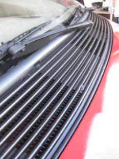

**** Cowl install ***
Pull pin till snug.
