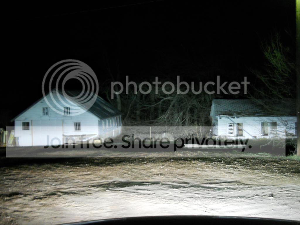

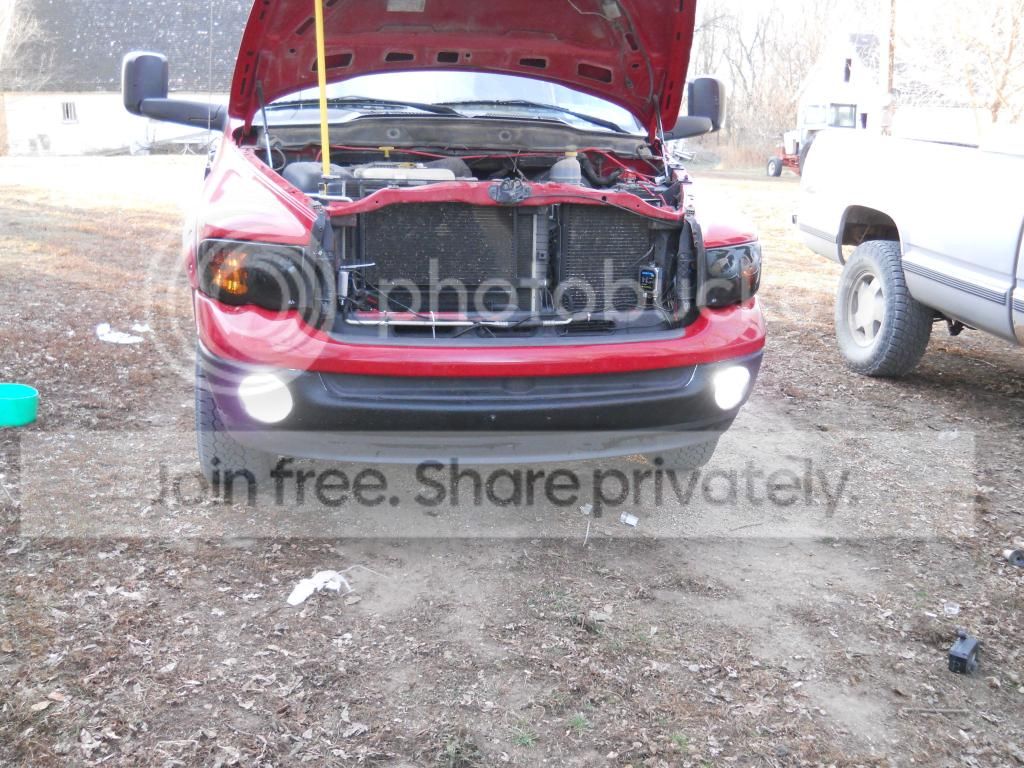

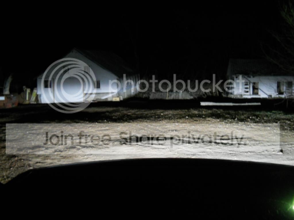

hid's are great if the bulbs are capped like mine are, it eliminates the glare you guys hate when meeting a car equipped with them on the road.
wbrook in my experience the 55watt 6000k are the brightest, but it must be 55 watt, most guys i see are usually 35 watt's and are annoying smurf blue
Fogs only
Fogs and main
