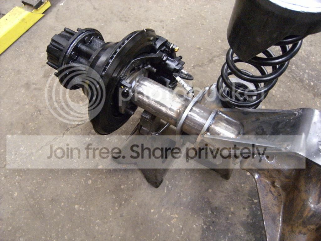

I've managed to make some progress on my differential this weekend. I started out with this:
And this is where I'm currently at:
I just have the coil springs there for mock up as the upper coil mount needs to be welded into the frame. Still have to change all the bearings tomorrow and get some paint on it.

That should soften the ride a lot . Is the 4 link a kit from somewhere or did you design that yourself ?

It's all designed by me and will be fully adjustable with cam bolts. The coil springs are for an econoline. I had ordered front ones for an E-450 but ended up with E-150 but in retrospective maybe better since I can always go heavier if need be. The link arms are going to be made out of an actual I beam from an old 1940's *****hutt disc seeder. I have one partially done but will have to take a picture. Everything is designed to meet or exceed original factory specifications
Here's some more pics:
