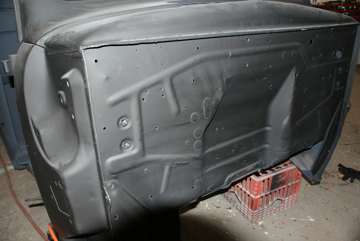

Here's what it looks like after getting sand blasted. I'm trying to restore it back to stock so I'd like to fill the holes that were added by previous owners but leave the extra holes from the factory even if they weren't used for the 6 cylinder setup.
Old Dec 1, 2012 | 08:05 PM
51PanelMan's Avatar
51PanelMan
Joined: Dec 2004
Posts: 7,669
Likes: 13
From: San Jose, CA
All of those holes look stock to me.
Old Dec 1, 2012 | 09:46 PM
ct50f1's Avatar
ct50f1
Joined: Dec 2009
Posts: 696
Likes: 48
From: Central Connecticut
I'm beginning to think you may be right. Do you know what the four holes on the left side, below the the rib under where the data plate goes are for?
