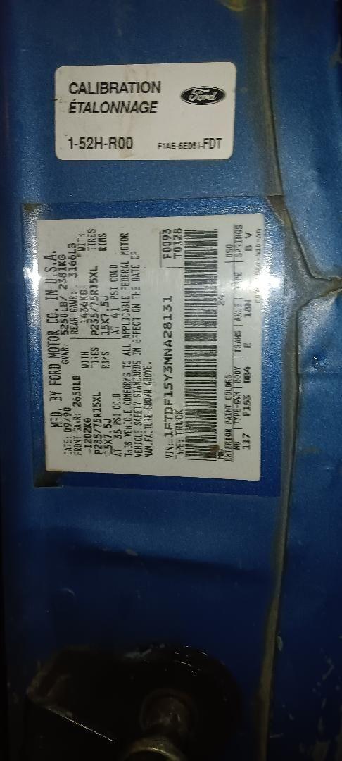

Hello all, This is my first post. I bought a 1991 F150 with a 4.9L E4OD Transmission. It has a Calibration code of 1-52H-R00. I have already searched through your posted list of Codes. I couldn't find this one. The ECM that was in the truck was the wrong one. I would greatly appreciate it if someone could help e out.
