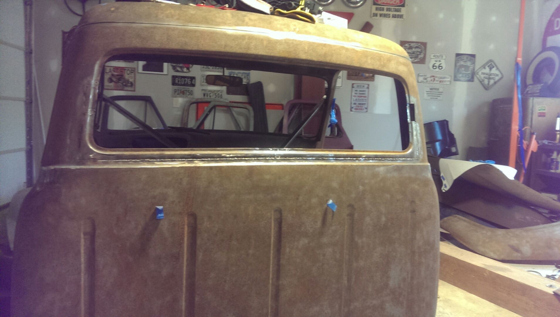

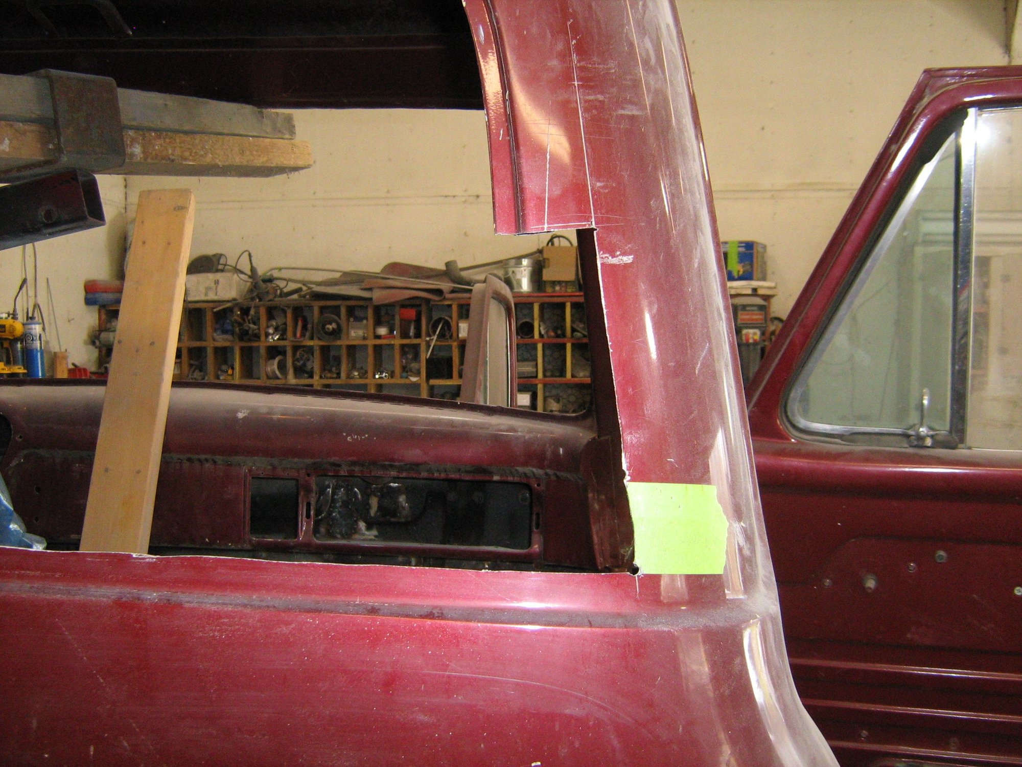

I wasn't sure if I could just cut the cab at the roof seam and get enough movement to drop the front an inch or so. Do you think there is enough movement from the roof seam to make the chop? If so I may try that.
yeah i want to do the back window like you did as well, was glad to see your pics of it to know i'm not the only one out there that wants to do that. Were you able to find a window seal that fit or did you glue the rear window in. ( I have been trying to figure out how i would do that part.) And 1 piece side glass helps a lot with masking the cab lean.

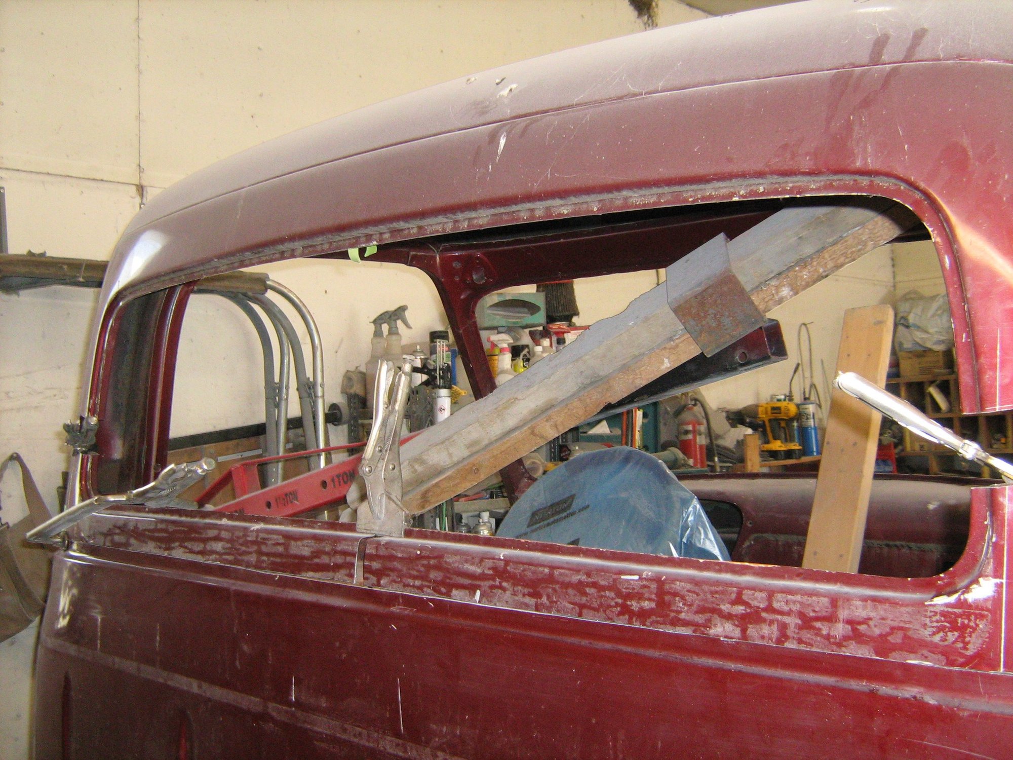

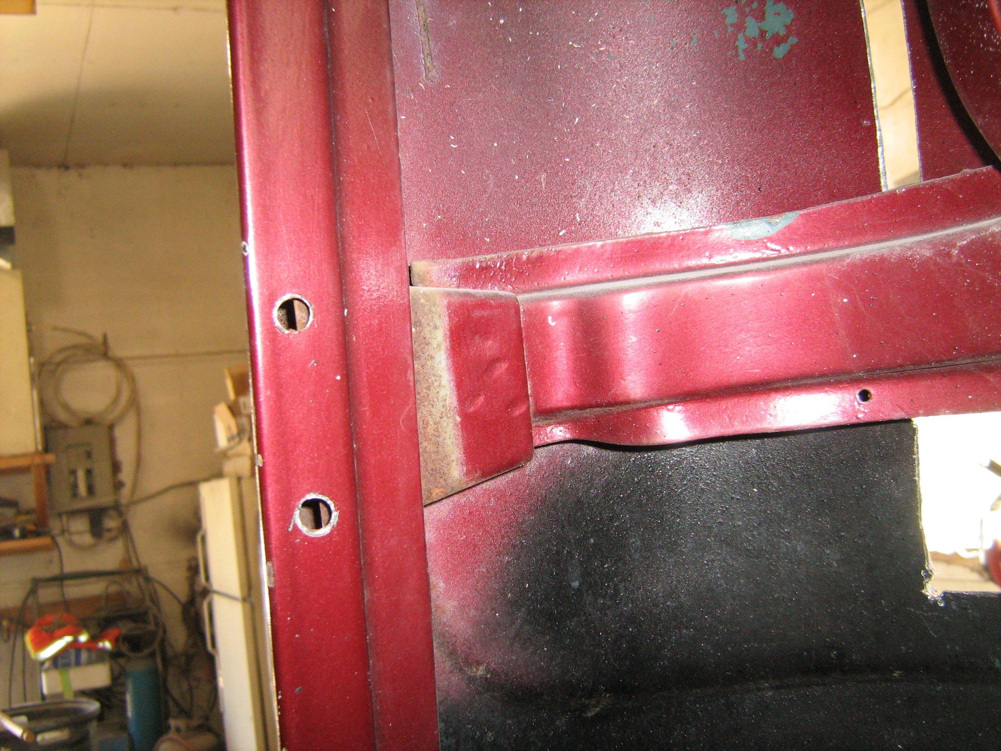

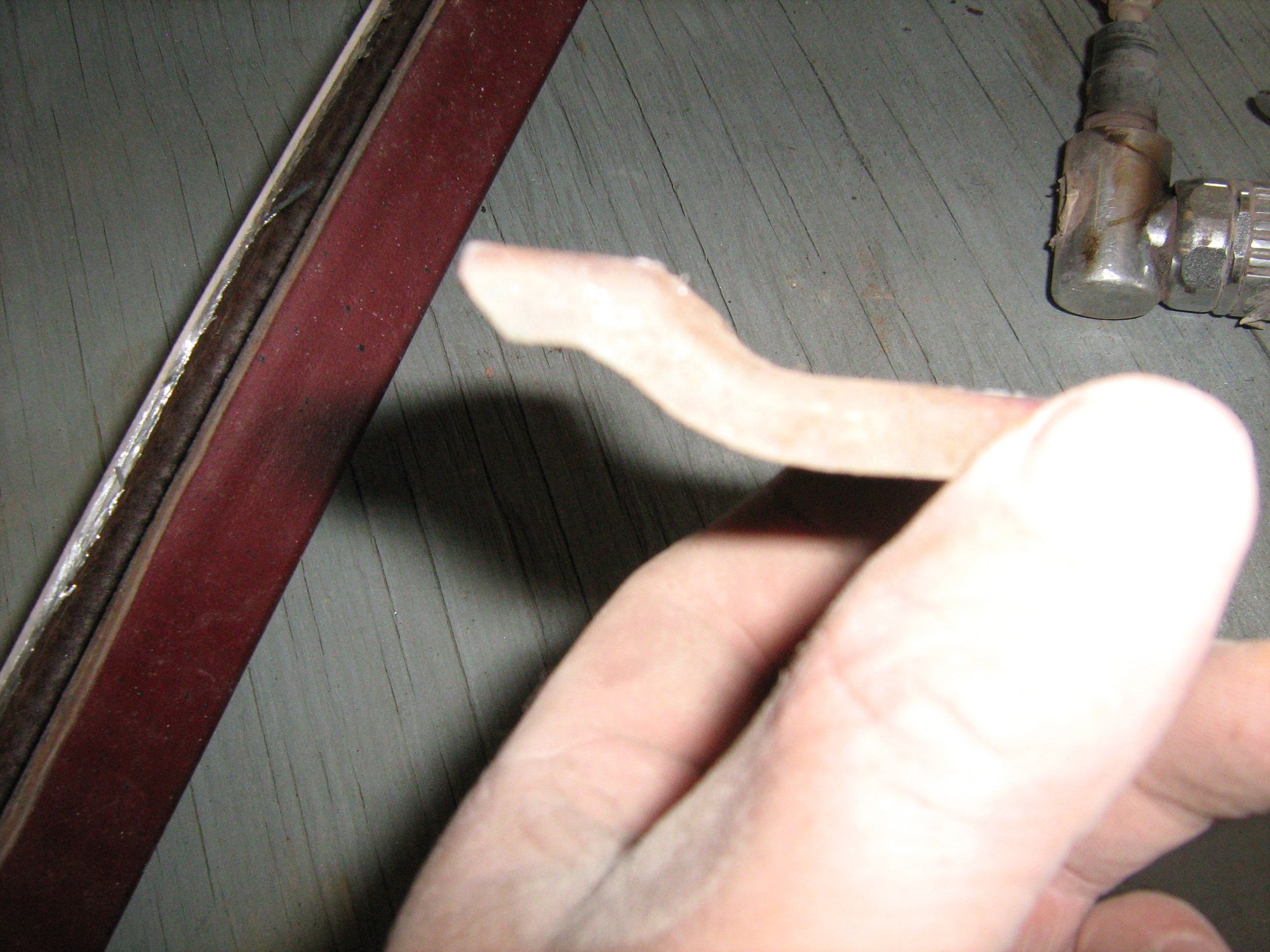

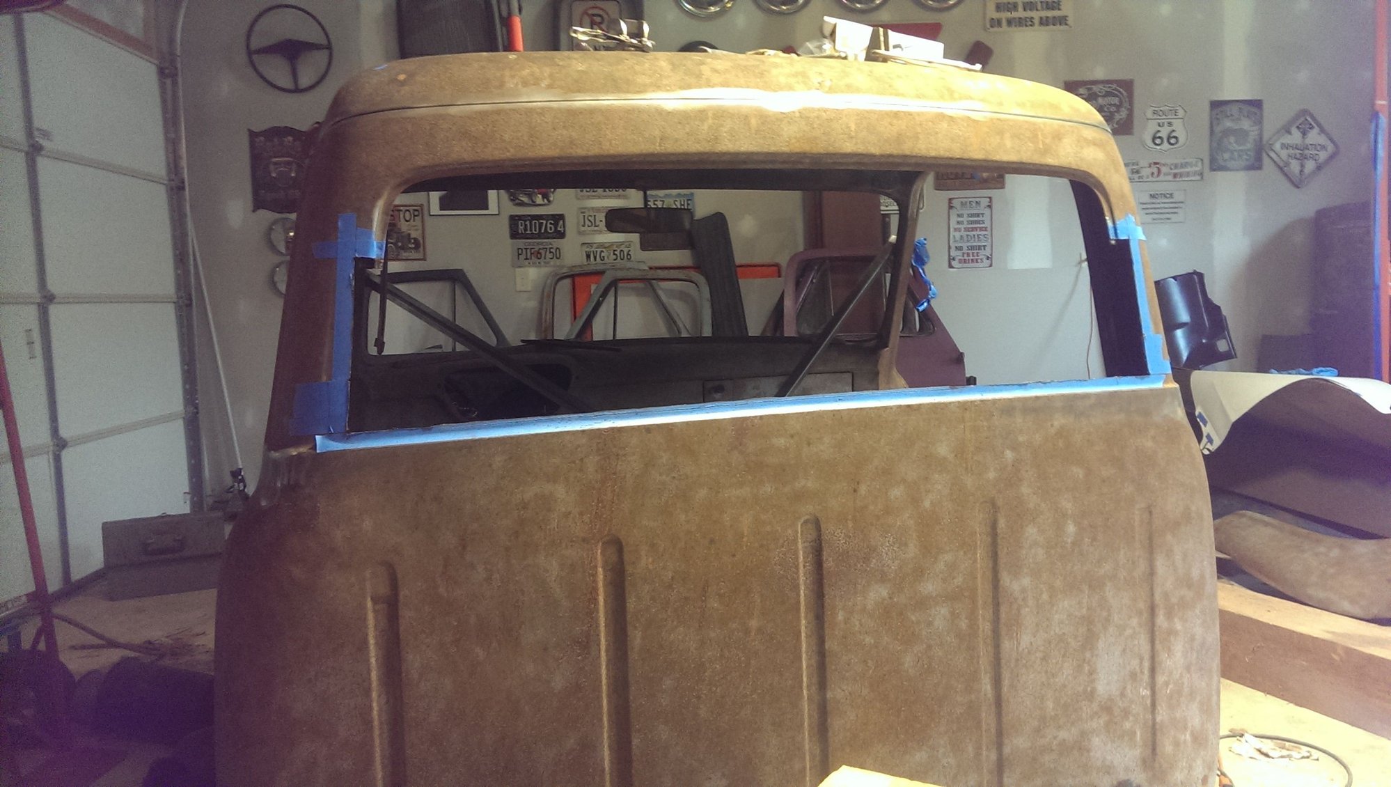

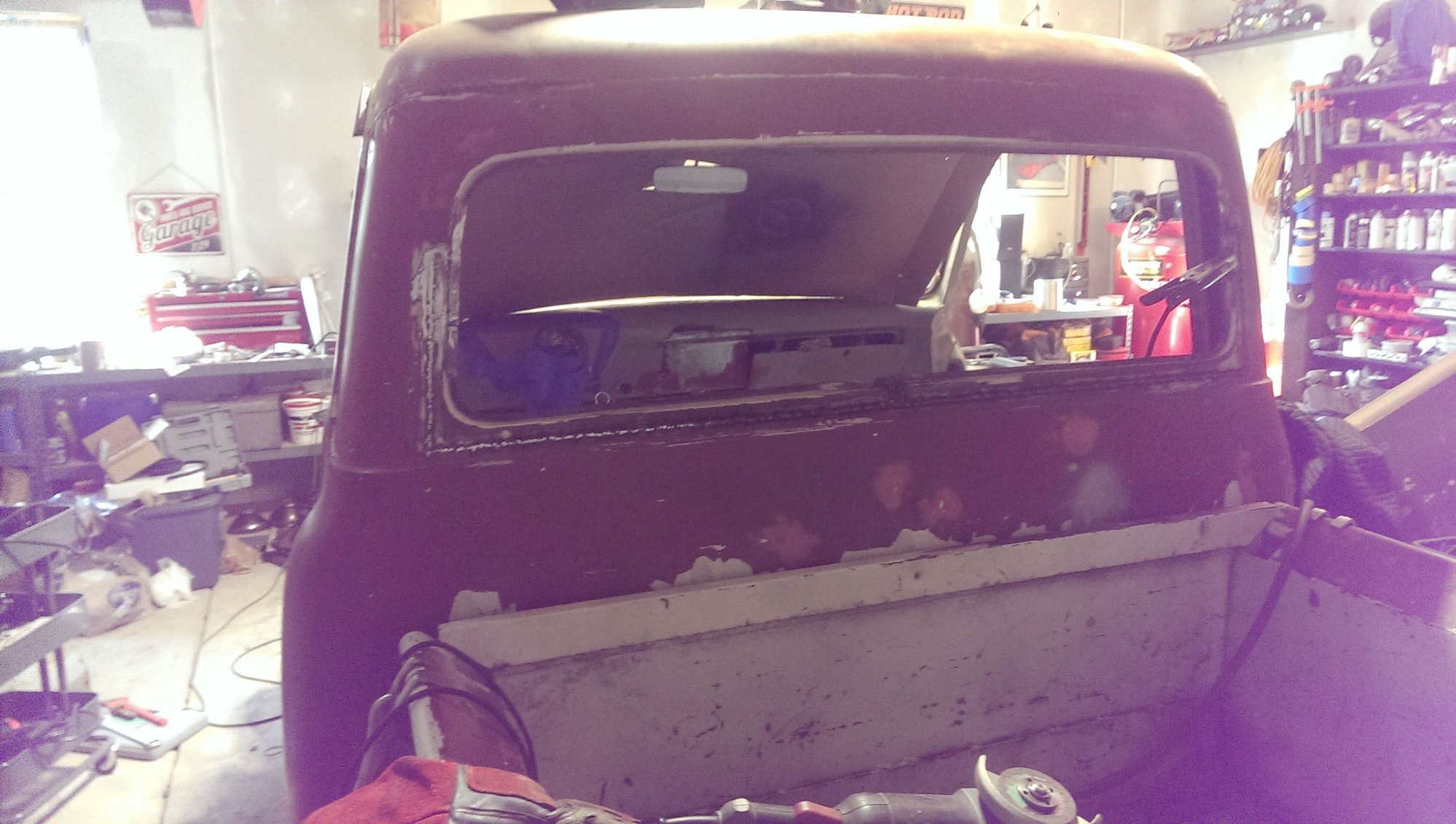

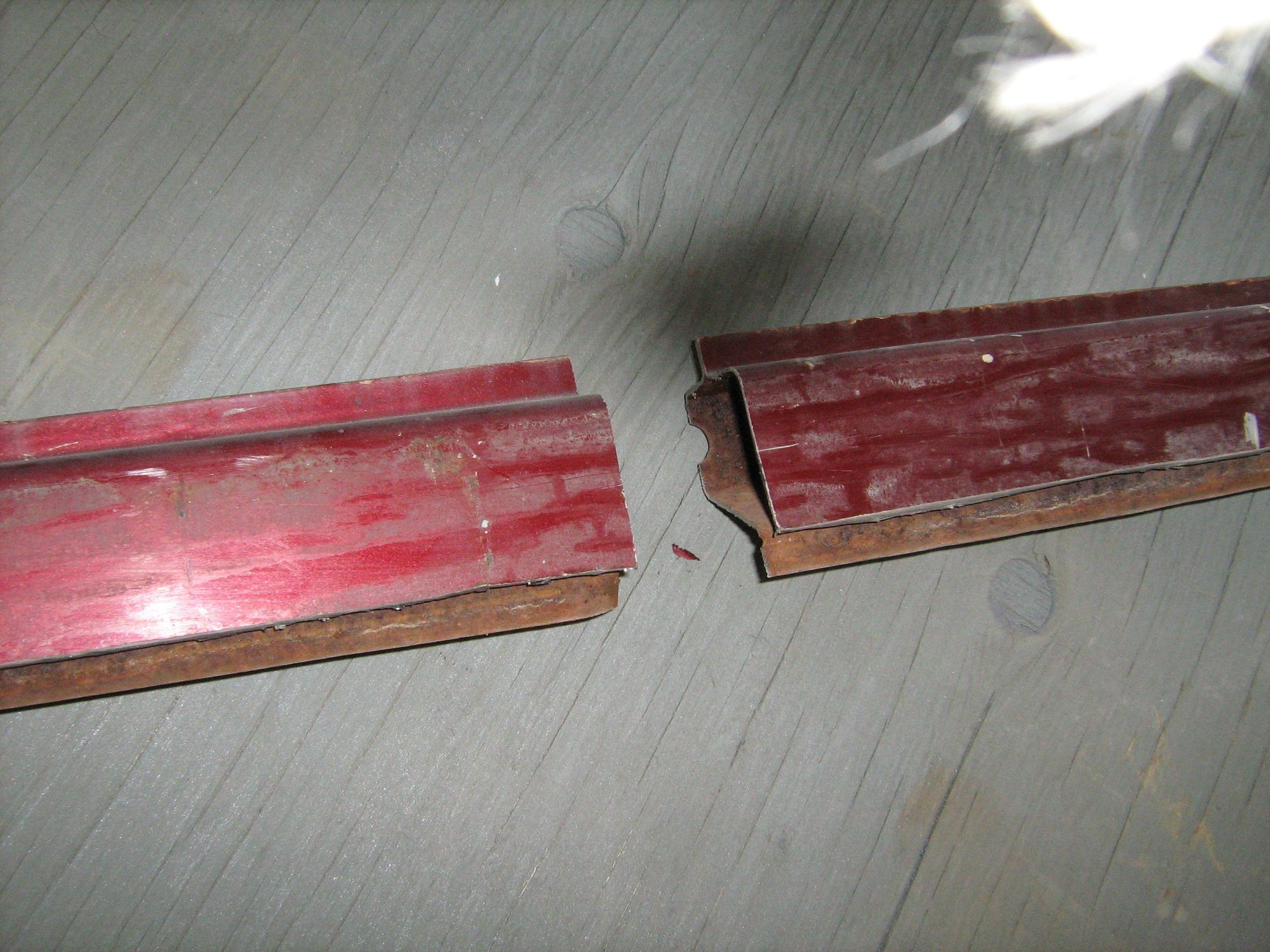

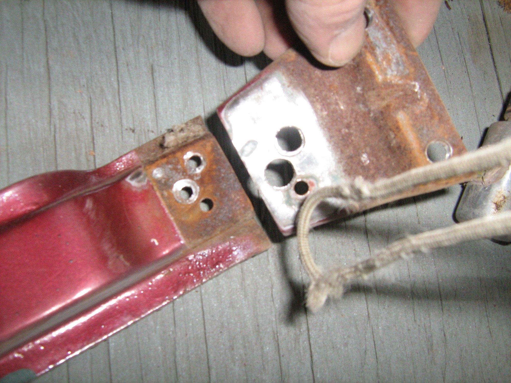

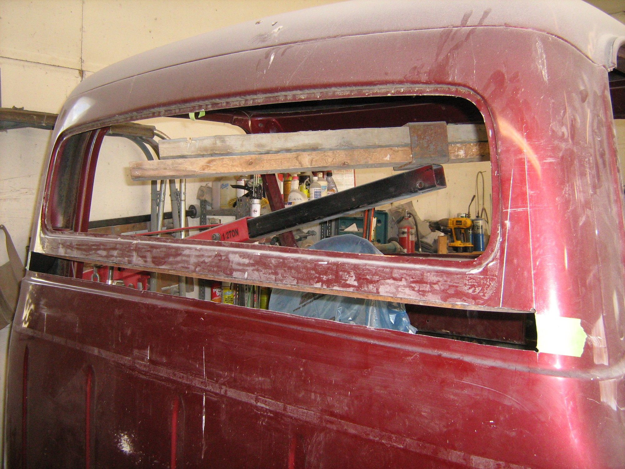

If you're going to fill the seam it wouldn't really matter if you took a little out . My guess would be if it was cut with a thicker cutoff wheel you would be good . I have not installed my window yet but you can buy bulk rubber seal so that's an option but I am considering urethane and different methods of using it .I don't recall how many pics I posted but here's all of them . The one thing I would do different is use a crimper and over lap the welded joint as even though there is a bodyline close it it was still quite flimsy and difficult to get solid .
2" cut out
drilled the spot welds on the brace
since the window needs to get wider to follow the cab line I cut it in the middle
cut with the outer cab line not straight down
the brace then needed to be a little wider also so drilled the spotwelds on the end pieces and rewelded
not a great pics but one of the filler pieces
only the end pieces left to make
all done

EBEAR, thanks for the added pics!!!! I started mine test run this weekend on a spare cab. Your pics were really helpful. I just have one more of the exterior pieces to fab. Made a piece that was long enough to do both sides but got a little overexcited and screwed up the first one so..... well had to use the other sides piece. Then I just need to tie it into the inner door structure. Did you end up needing to cut the inner structure in the corner to get a little adjustment?

If your referring to the brace that runs along the bottom of the window on the inside , the very end pieces are also spot welded so I drilled them and moved the accordingly .

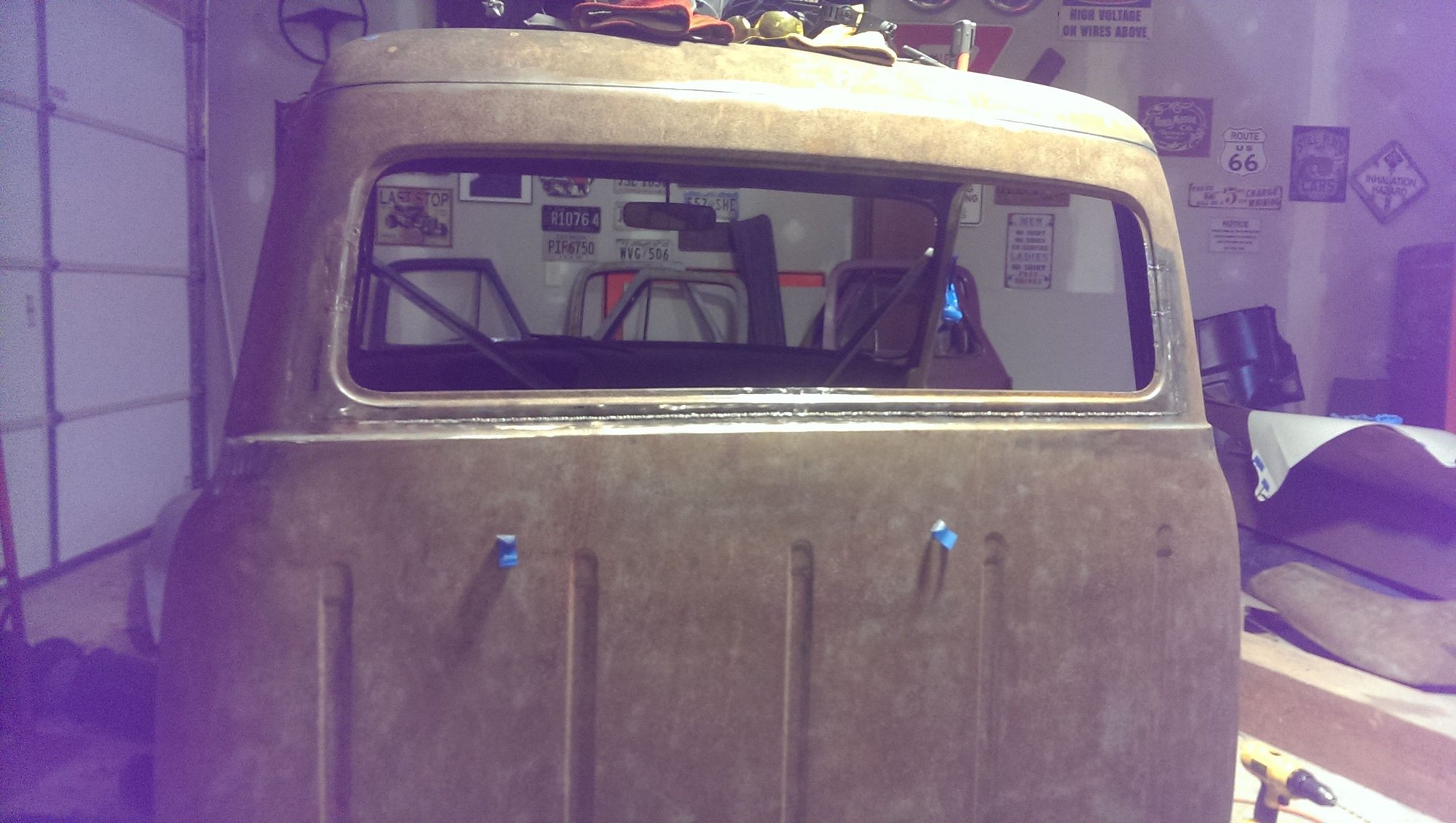

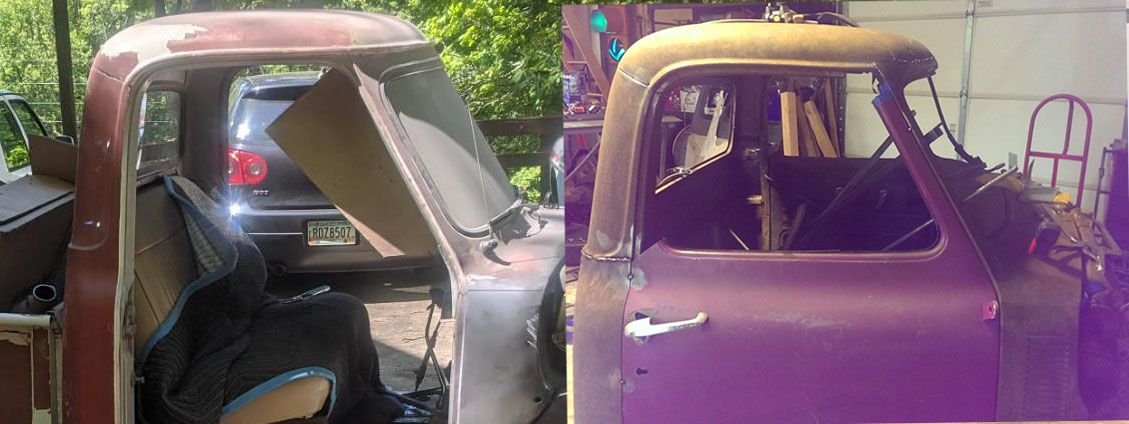

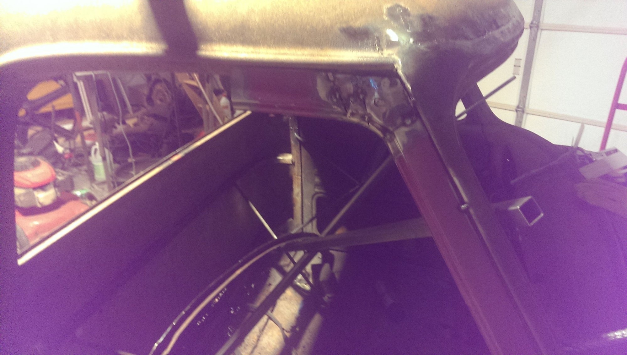

Hey EBEAR, Thanks for the info, got my test cab work started, coming along pretty well. working on finishing up my doors. but the back window went pretty well. don't know if I will end up chopping my actual cab but still a good learning experience. the second pic is my actual truck cab next to the test cab, def a huge difference

From the pic it looks like you shaved the drip rail and used that seam for your join along the front which is the same conclusion I came to . What did you do on the inside ?

Yeah I figured just removing a strip below the drip rail would be easier but I like the drip rail over the doors and not over the windshield and usually when the drip rail is removed they leave the odd body like so I figured I could kill 2 birds with one stone. I haven't done the inside yet, working on the door tops at the moment. But I did cut the inner structure in half and plan on putting it back in, it will hopefully just be an inch shorter and then installing the roof support back in place. if this was my actual cab i intend to use I would round the corner of the door and bring the drip rail down the pillar about 1-2 inches to keep the functionality of the drip rail

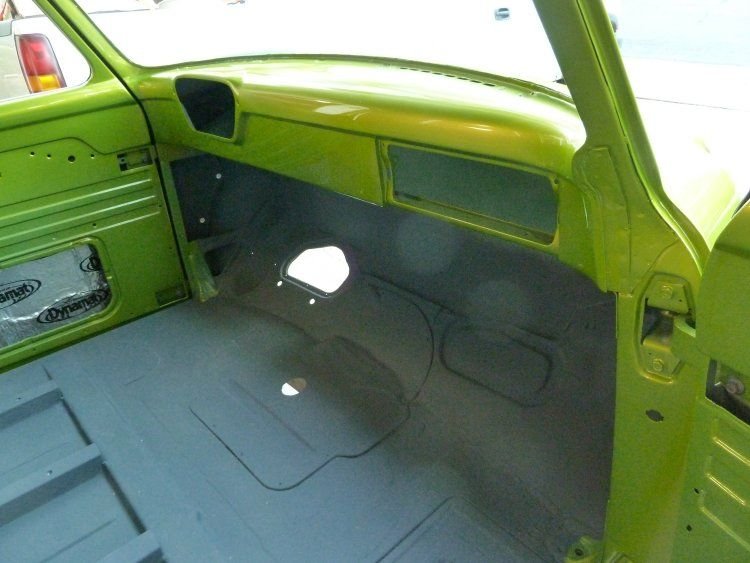

Hey EBEAR, thought you might get a kick out of this, I was a little worried about starting the work on my actual cab so I did a few smaller things to keep myself feeling warmed up. Was worried the practice cab might have been beginners luck so I made the glove box door wider and got rid of the ash tray, filled a few homes in the dash and about 100 holes under the dash. (evidently the previous owner felt that was where every screw needed to be placed to hold any and everything) but it came out great, now for the long part of cleaning up the welds. EBEAR, what did you use for your actual window install?

I have filled many a ash tray but never thought to widen the glove box door...nice work. Here is the last slant cab I did, used one of Mid-Fifty's dash panels to cover all the sins of previous owners...and the ash tray.
