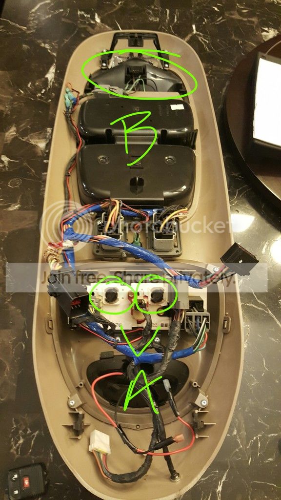

My OH lie o meter took a dive for the second time in 12 years. I also noticed the backlight lamps(A) for rear HVAC controls were out. They can be removed from console, and lampholders easily. Can anyone recommend an LED replacement that will last, and doesn't take a month to get in hand?
I'll do the rear dome (B) while I'm at it.

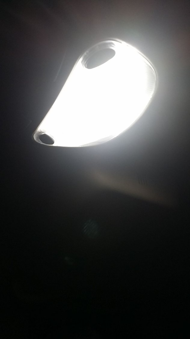

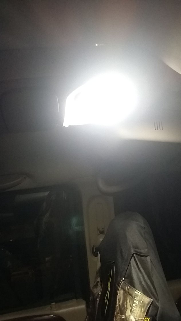

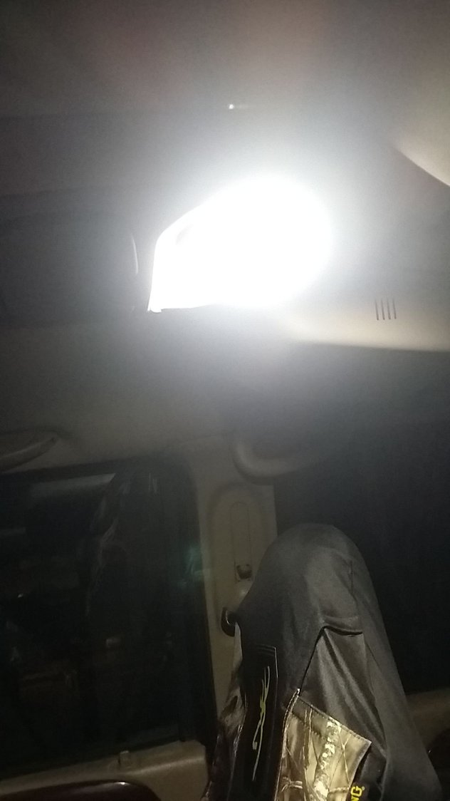

Light output on mine after conversion with 2 zevo 921 led 6000k bulbs
Its completly dark outside phot outside truck show how bright bulbs are Sylvania zevo 921 led round 6 node bulbs 6000k temp
what yall think
