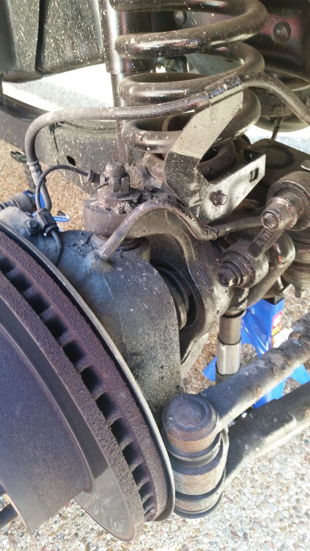

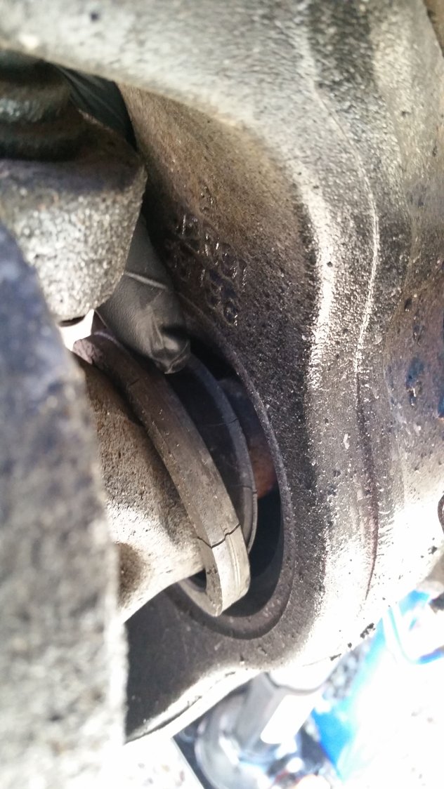

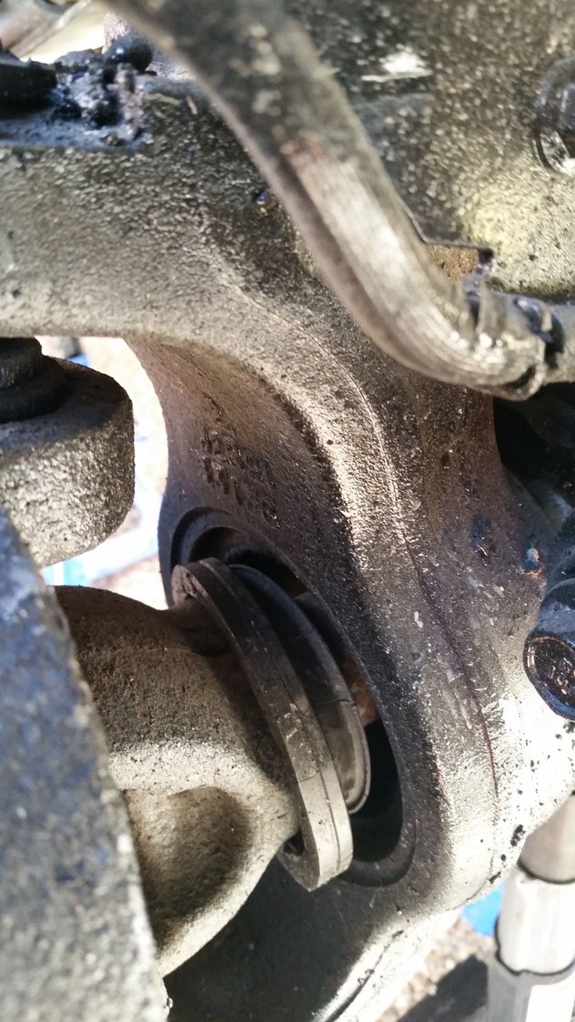

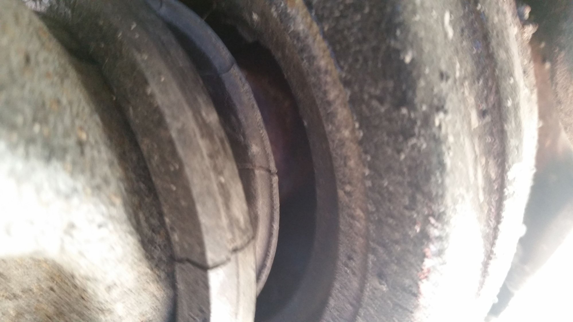

Got the front pass side wheel removed and saw this axle seal or cover that is no longer intact. I wasn't really planning to tear this down right now, I just removed the wheel so I could get to the alternator from inside the wheel well. Not sure what this seal/cover is called, or if I should replace it now while I've got the wheel off. There are a few other things going on with the truck that should probably take priority before I go fixing anything that isn't quite as critical as a small coolant leak or a bad drivers blend door actuator. If I ignore this for now is it going to back and bite me in the ****, i.e. like take out the axle and/or differential? I took several pictures to hopefully show what I'm talking about. In the last pic (I think) it shows some rust on the axle inside. How serious is this?

That is your axle dust seal.....they pretty much all go like this after some time. There's a revised part to replace these with that lasts a bit longer. To replace this you'll also have to replace your knuckle seal and wheel bearing/hub o ring in order to maintain ESOF operation, as they are one time use seals, and when removing the axle to get to this dust seal are damaged. Unless you're going through a lot of deep mud or water you won't hurt anything really if this seal is busted like it is. You can try and seat it back in without taking anything apart...but if you manage to get it re-seated it is more then likely going to pop out again. Most guys don't really worry about this seal to much.
