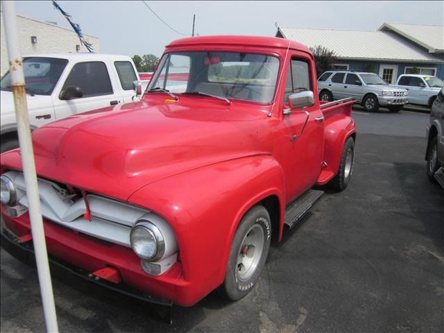

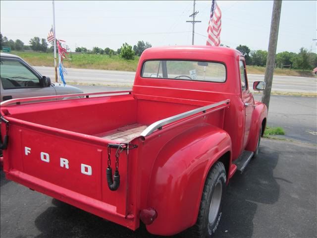

Hi all, been lurking for awhile but finally bought my 55 F250. Still getting familiar with the truck but one thing is bugging me. The running boards have been bubba'd to say the least. It's a 250 but it has a short bed installed. Among other things to figure out, I have to figure out a replacement for the boards. Bottom line, they don't look level. Any thoughts?
I can get better pictures but I'm confused on how a new set would mount. I've never seen the small (red) step the way it's molded. Something like it is it's own independent step-side. Is this a different model bed perhaps?

Looks like the bed/fenders are off a 57+, they had the short running boards on just the bed like that, and they where mounted about an inch up. Should be able to find a set of F100 running boards from 53-56 and have work (the bed is no different, just those mounting holes on the fender). The front running board on your truck sorta looks custom to me, hard to tell from that angle but stock boards tend to follow the line of the front fender rather than be cut perpendicular to the cab.

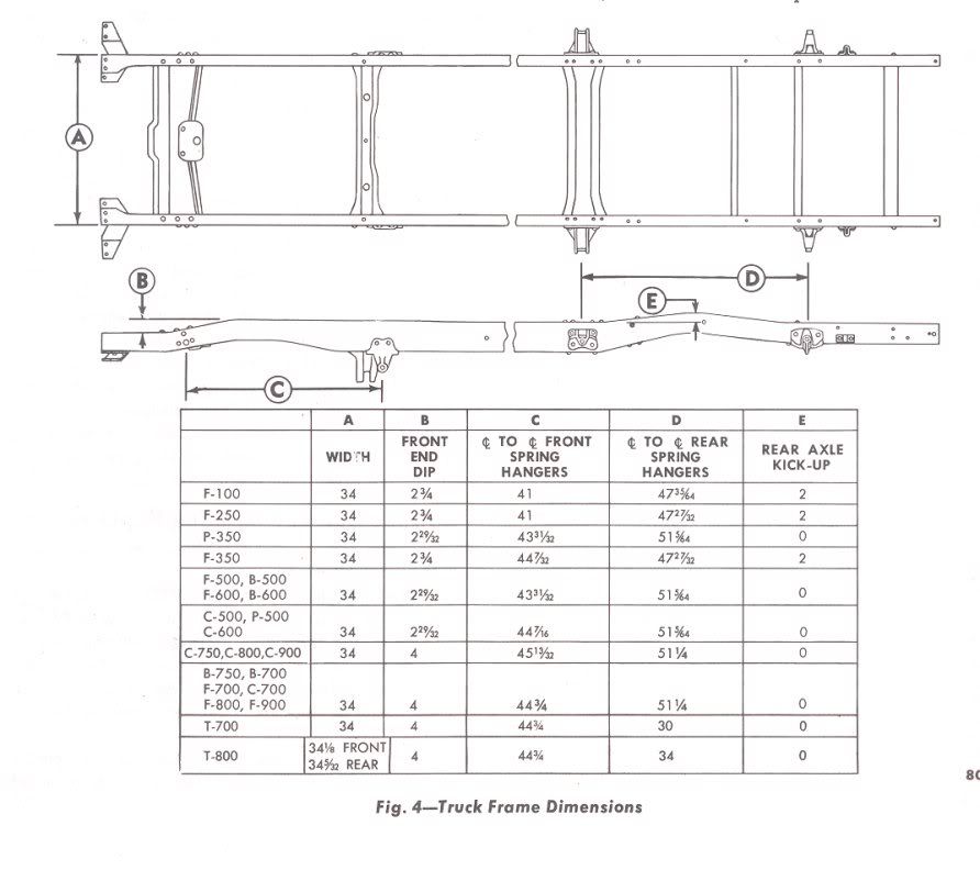

However it's possible that it might need a little a little more custom work if it has a non-stock frame on it. I don't have a set to measure but someone here should know exactly how long the running boards are before you buy some, because if you have a different chassis under it depending on how it was done you might not have the same wheel base. (which would require shortening the running boards, if your distance is longer instead of adding to f100 running boards I would shorten f250 boards, it's easier.) A f100 has a wheel base of 110", an F250 is 118", but you'll want to compare the distance between fenders to see if you'll need to modify the running boards or not to fit. I don't think you will though.
Another problem you might have if the chassis is different is the bracket that goes on the frame for the boards at the bed might need to be lengthened. Modern chassis tend to go up after the cab, these old ones where pretty flat:
See how it goes back to the same height after the bump for the axle? Modern ones tend to stay up higher. The reason I think yours might have been swapped out is in order to make the bed sit at the right height with using a modern chassis some of the space inside the bed gets taken up. I don't have measurements for a 53+ bed handy, but on a 52 and earlier it's about 20" from the wood to the top of the sides of the bed. I only notice it because I spent a lot of time researching out swapping chassis on a truck.

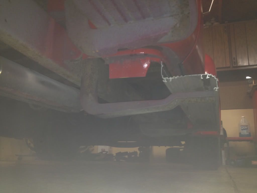

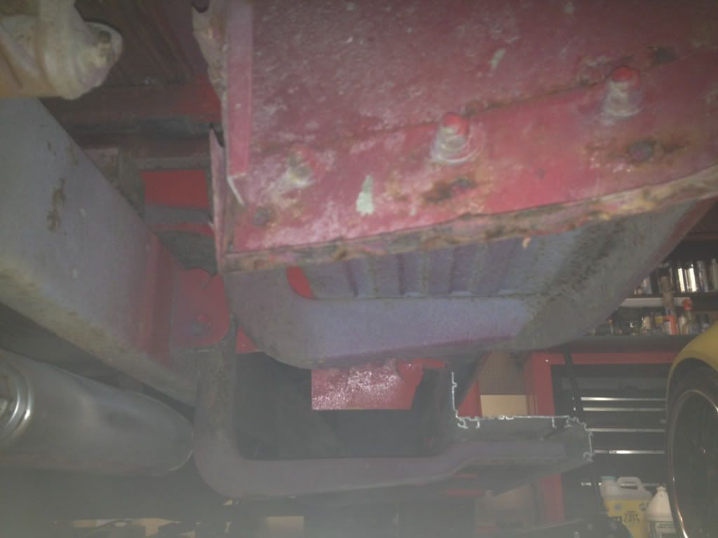

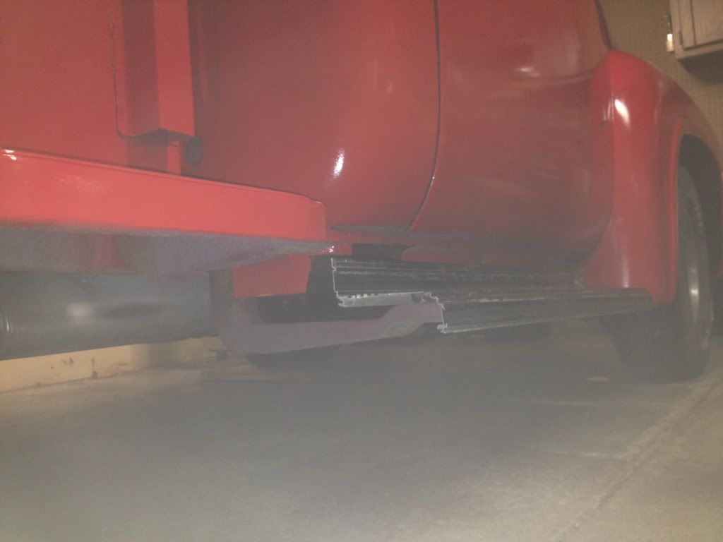

Board shots
I wondered about that very thing Abe. Here are some shots of the mounts:
So I had a few questions. Do you think it would be feasible to lower the bed mount? What about mounting 55 fenders? I'm just not used to the idea of swapping body components. Finally would there be any custom options for lining the cab up with the bed, like the 57 models are? Maybe cutting the board mounts under the cab and remove the boards all together?
