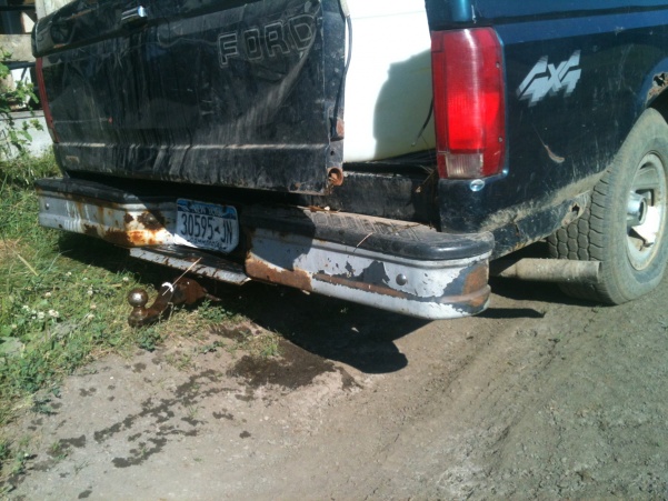

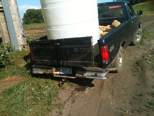

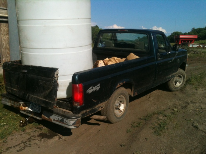

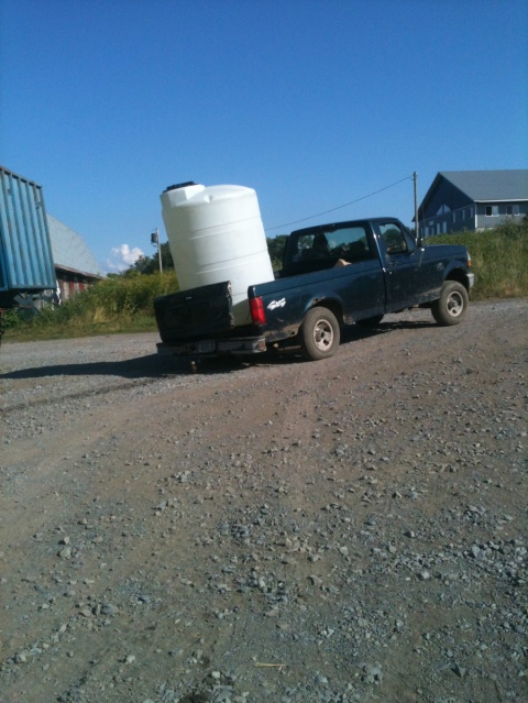

DAds 94 f150 hauling a tank of water for our shortage. Tailgate never latched but always held on with a come a long but the op side came undone suprisingly it didnt come off. The hitch was dragging too

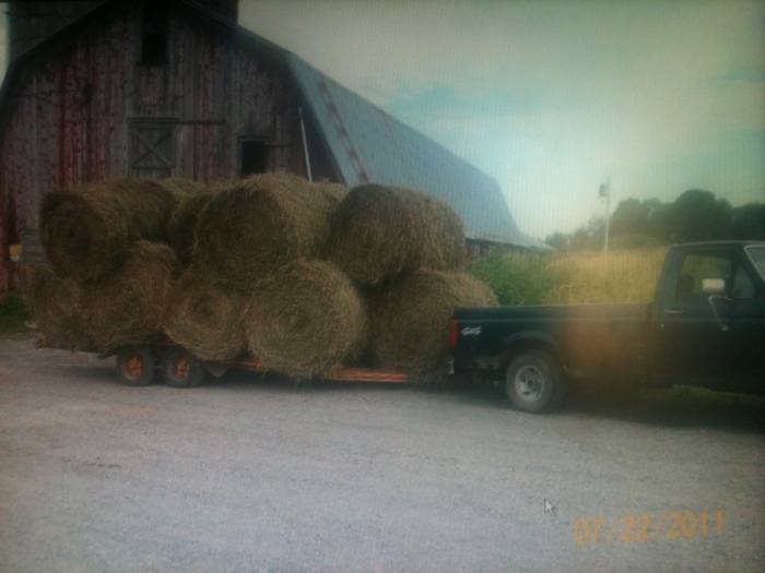

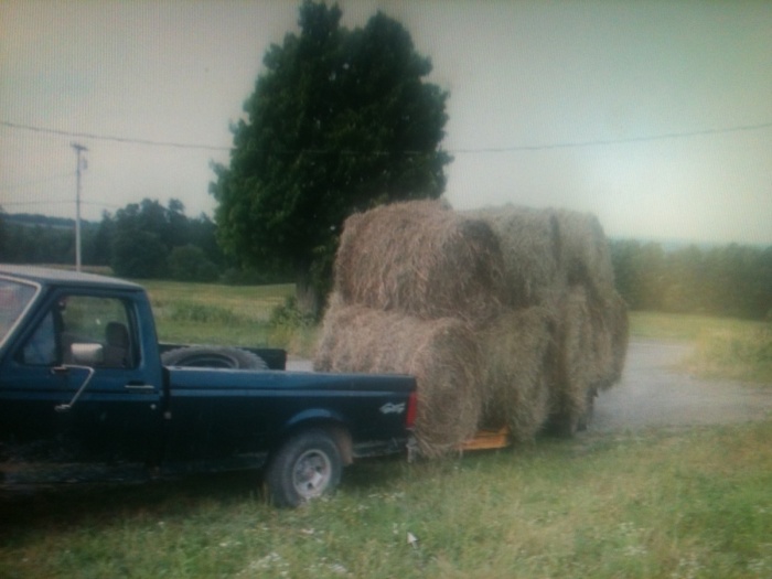

and pics of last yr hauling around 18 round bales. the most its ever hauled before. it usually handles about 12 but we didnt feel like making a second trip for half a trailor worth. it made it home just fine

Just saw an IDIOT like him on the road yesterday, hauling hay bales like that in the bed of his truck, and on a trailer. That thing was way overloaded, and I sure thought it was awesome when I saw a Sheriff flip a U-turn to go pull his *** over for it.
Your Dad should get a truck that can handle that kind of weight. He obviously doesn't know how to secure a damn load properly either.

I open it and see an extremely overloded truck that is UNSAFE for highway use. Look on the door pillar and you will see what weight that truck was designed to safely haul and carry. Look at the "D" shaped tires and the trailer hitch dragging on the ground, headlights pointing to the sky, those are all indications that YOU ARE OVERLOADED and UNSAFE. How is the braking and steering when you are loaded down like that. I wouldn't want to be on the road anywhere near you hauling a load like that, it's pretty scary even to look at.
And no, your load wasn't secured propeerly, if it was the water tank wouldn't have slid back into the tailgate breaking the hinge.

The hing never latched like i said its always broke the tailgate is junk

I don't think either situation would be legal for even an F-250 which has a load capacity (in the bed, not trailer) of around 2000 lbs depending on options. Is that a 500 gallon tank? Was it full?
The trailer is no better. In both situations, you've placed the weight as far behind the rear of the axle as possible. Ignoring the grossly overweight loads, this is the worst place to put a load because it's going to prevent proper steering or braking control.

500 Gallons of water, 8.34 pounds per gallon, 4170 pounds on the very edge of the bed, barely held in by the tailgate. You're overloading that truck by 3x or more its rated payload.
It's not fine, it's not safe, and it's not even sane.

We go at most 2 miles down the road mid day when nobody usually ids around cause there working iits no like we do this at 5-9 at night. Yes it is 500 gal water tank it was full. We have absolutly no water so we got to transport it somehow

Less weight and more trips is how.
