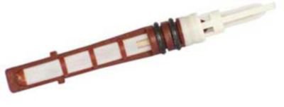

Sorry. Missed the vid the 1st go round. It looks like it is building pressure VERY quickly. TOO quickly. Like there is a blockage. I would be looking at the Orifice tube being blocked with trash

ok before I dicked with the pressure gauge (sunday) the thing would NOT spin at all...so I assume thats at least a good sign right? and Brad im not 100% familiar with the AC system, I know enough to do basic repairs to the truck, where would the orface tube be located, if I can find that I would attempt to check for any type of trash or what ever.
I do know this is what i need to look for or something like this
That's actually a common issue Brad....
The A/C compressor starts grenading its' self internally, etc...
And then when you look at the Orifice Tube, it's covered in "The Black Death" aka shavings, bits of seals, etc....Then it's time to replace it..

https://www.ford-trucks.com/forums/6...fice-tube.html
There ya go Jaime....
The Accumulator is next to the Blower Motor Housing...
Passenger Side, up next to the cowl...Can't miss it...
