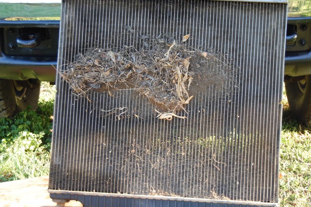

I couldn't see this at all until after I removed the rad..
I think I see some eggs in that nest!
