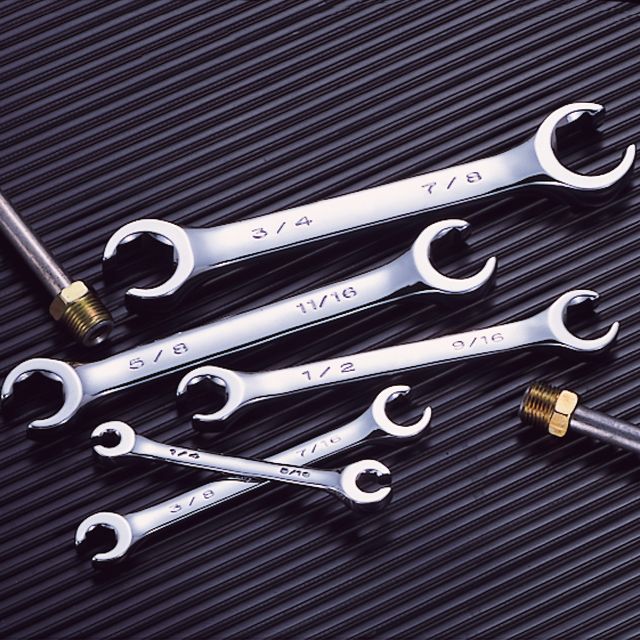

I've always called 'em Flare Nut Wrenches:
Craftsman

I bough a set of three flare ones from O'raelly - easer it's to late or they are poor quality and making the same mess

I have a set of craftsman wrenches and they work good if they are not too tight, otherwise the wrench spreads and slips around the nut.
Craftsman
X2
Usually work good for me, just have trouble keeping my son from using them as regular open ends.

the tubing wrenches are your only chance...and yeah, even with those you won't get them all off cleanly on a flare nut that's been on there for 30+ years.
