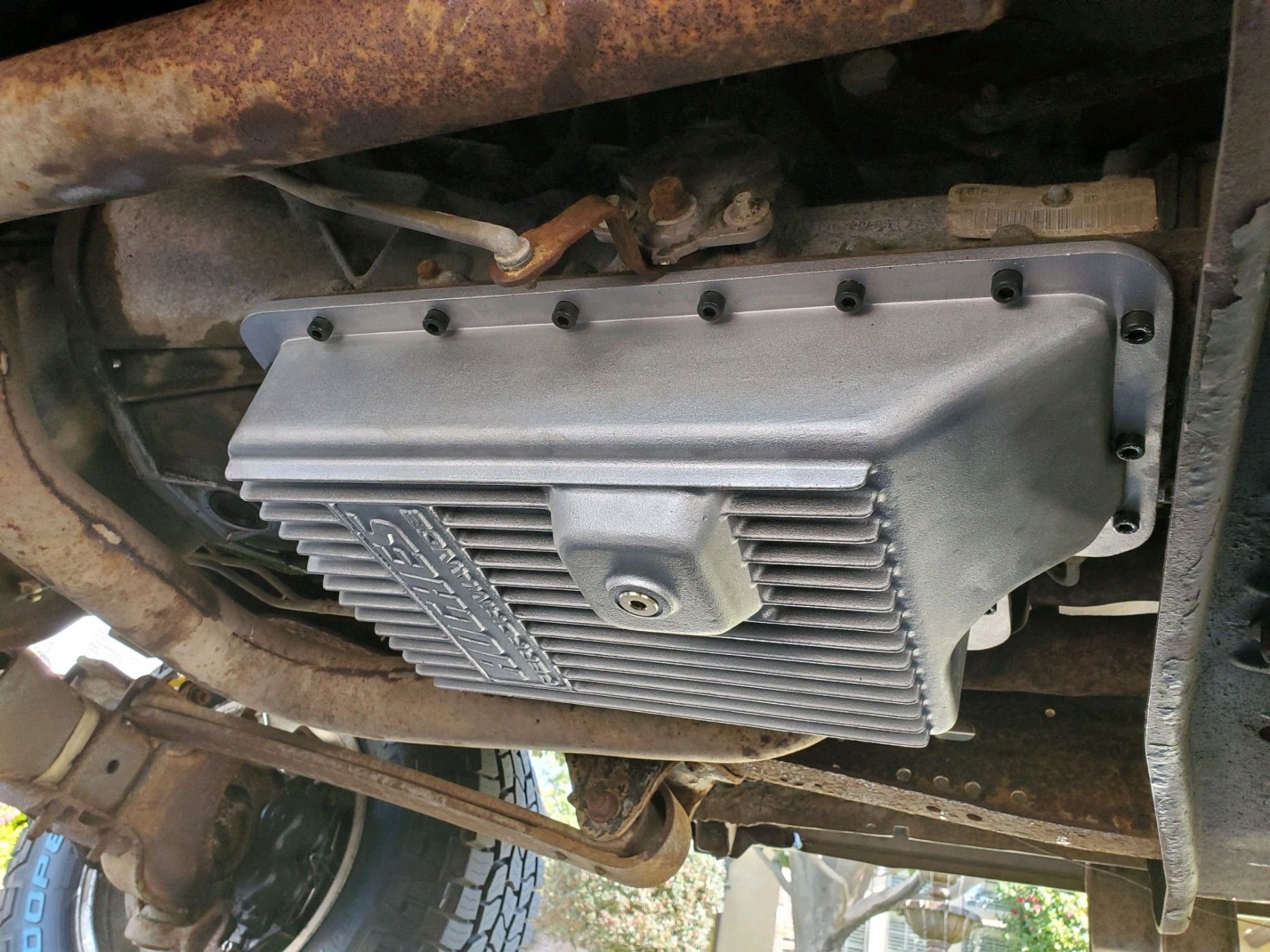

I have to tell you my experience with Punisher Valve Bodies and Paul was amazing. I recently purchased 1991 Ford F250 with the 460 and 4EOD For one of the most challenging climates on the planet, Baja where I recently bought a home and where a new or nice vehicle can make you a target. It is beautiful but completely unforgiving and an "oops" down can be catastrophic, at best it means a long walk home or it could mean not getting home.
Despite being a 30 year old crusty mess of a beach truck from Coos Bay, Oregon my F250 only has 79,000 miles on the clock and despite needing all the belts, hoses and brake components replaced it drives like the barely broken in truck it is. It's recently come back from a complete service which included everything it needed to live another 30 years. When I got the truck back the transmission was behaving radically and disconnecting the battery helped but it was still given me a squishy shift going into 4th which could become problematic on the many on and off road surfaces its going to be living in.
Growing up a Ford guy I had the getting great fortune of living across the street from one of Carroll Shelby's original engine builders and legendary drag racer Tony Storer who saw the Shelby Cobra for what it was, a great little hot rod and potential drag car. Tony went on to dominate In his creation, the Dragon Snake. I helped him rebuild my first transmission, a C4 and understood the value of a top notch shift kit from his teachings. I also knew I didn't have the patience to be an automatic transmissions guy.
So when I got my truck back it was being a little squishy beteeen 3rd and 4th. I actually purchased a new high capacity pan, the shift kit components and everything else I needed to make my transmission live but I wasn't excited about doing it, screwing it up or getting it not quite right. I stumbled on Punisher Valve Bodies here in the forum and knew I'd be better off going with it based on the feedback of those who had gotten one from Paul.
I have to tell you, it is everything people say it is. The shifts are firm and crisp, the shift points are perfect and it was easily done on the street in front of my house. Going the extra distance I opted for one of the much larger aluminum transmissions so there are now 9.75 quarts in the pan. Thanks Paul.
