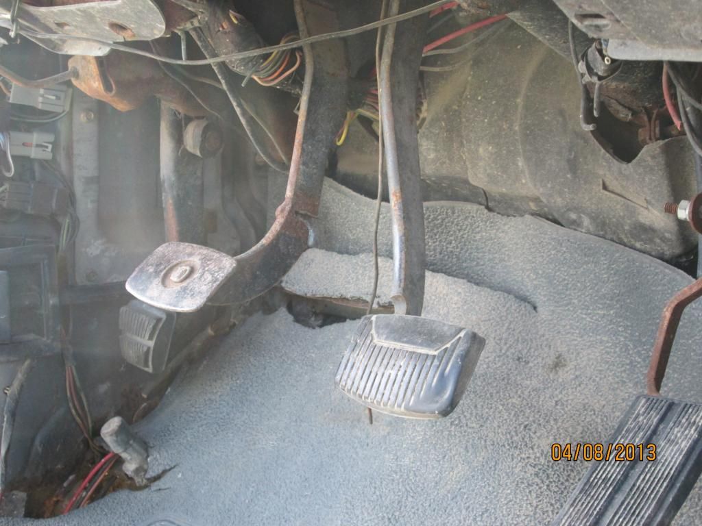

I acquired a 1988 F250, 460, 5 speed, a couple of months ago. I discovered that the firewall is cracked and is not allowing the clutch to fully disengage. Based on the posts in the Ford Forum I ordered the reinforcement plate. According to Ford's bulletin, this is a major job and maybe beyond my expertise. My mechanic estimated 9-10 hours based on his past experience and will be too expensive at $1000. I am looking for some help from someone in the Denver metro area that has the experience with this repair and that would be willing to do this repair. Please let me know.

Well another option is you can cut the pedal off, and re-weld it at an angle to give it that extra travel like done here

I sorta installed the reinforcement recently. I say "sorta" because my cab is stripped to absolutely nothing and on a rotisserie. So, I had nothing, whatsoever, to take off or put back on. But even then it took me at least 2 hours to lay it out, drill the holes, and massage the reinforcement plate to fit. So, if you had to remove and replace the steering column, brake booster, and brake/clutch pedal assembly you could easily see 9 - 10 hours
But, to get to $1000 you would have to be paying $100/hour for general mechanical work, and that sees very high. I would try another shop.

It took me 20 min to install mine in my stripped down naked cab....
Just a few taps of the hammer on the side of the firewall, and it fit perfectly.
