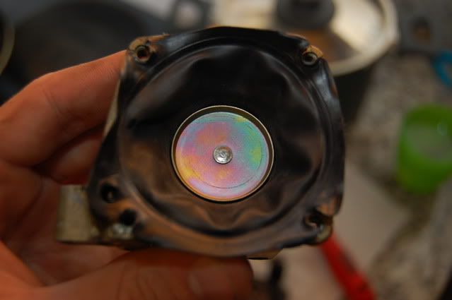

Dug into this today, and found the following after opening the secondary housing. Is it supposed to look like this? All the pictures I've seen of the diaphragm is that it looks different from this.
According to Holley there's supposed to be a black spring already in the housing, and when i tried the "bag zip trick", it didn't appear to move at all.
Figured id check the housing anyway.
Will i need a new diaphragm?
Thanks!

Ye[ that's what it looks like. And there's a spring that rides on top of the diaphram too. Holley sells a kit with about 7 different sec springs so you can tailor the sec opening to the motor's needs. The black spring is the heaviest of all, on a 302, you'll never see the secondaries open with that spring. In a 600(on a 302), it'll only open at around 5000-6000 rpms.
