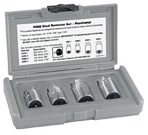

Heres what i used to remove exhaust manifold studs. They work awsome. If the 5/16 is to big Irwin makes smaller sizes part # 394100

Actually this is what you need. This style of stud extractor is certified bad ***. Been using them for years to pull 4.6/5.4 exhaust manifold studs out of heads. They have a cam lock inside. They have so much grip that i have actually twisted the studs off inside the head when they were stuck to that point.
